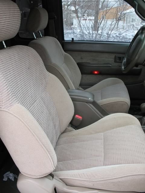

    I installed seats from that year range 4 runner in mine. The mounts closest to the trans tunnel line up fine. On the outer rail, I had to swap the rear mount from the Taco seat, and once the seat was bolted down, bend the front mount down with a BFH.
    Somewhat related, there was a little wear on the outer side of the driver's cushion, so I swapped the cushions between the driver's and passenger side. They are very easy to change.

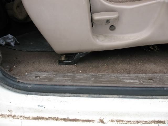

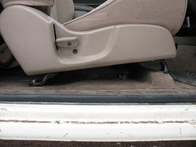

    4Runner seats
    This rear mount has to be swapped from the Taco rail to the 4Runner rail
    The front mount has to be bent down
