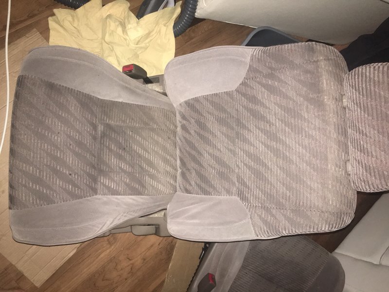

  5. Feb 9, 2017 at 8:25 AM
    SolitaryNomad
    SolitaryNomad [OP] Well-Known Member
    Sep 29, 2016
    #198524
    178
    Eric
    2003 Tacoma TRD Offroad
    None (yet)
    These are the seats

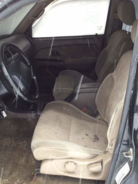

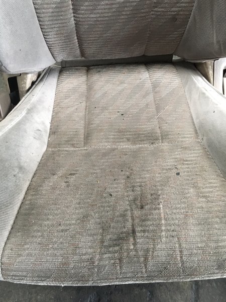

  12. Feb 9, 2017 at 10:21 AM
    99SuperTaco4x4
    99SuperTaco4x4 Well-Known Member
    Apr 26, 2016
    #185380
    954
    1999 3.4L V6 Tacoma, 4x4, TRD Supercharger
    And mine were dirty. $15/4 hour homedepot wetvac + chemical guys fabric cleaner did the trick.
