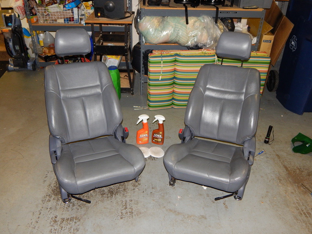

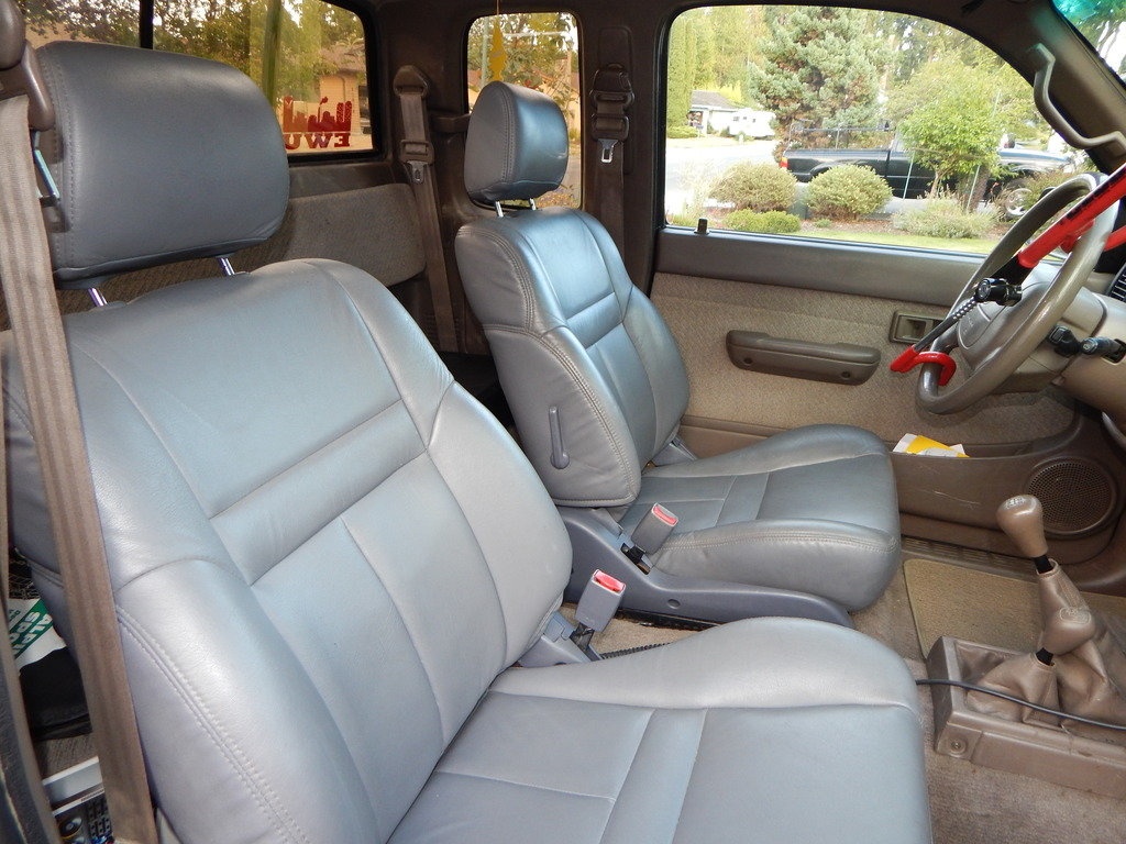

    I did a seat swap to 2000 4Runner leather seats. It's a bit of work to make them for right. In my case only the two holes closest to the center of the truck lined up. I welded my other mounts from my old seats onto the seat rails. Just took a little measuring and time...

    Paid $150 for the pair of them. They were in a local wrecking yard and they had some surface mold. Nothing a good treatment with Lexol cleaner and then another two treatment with Lexol conditioner couldn't take care of though. They cleaned up great and are still super supple, I clean and condition them twice a year.

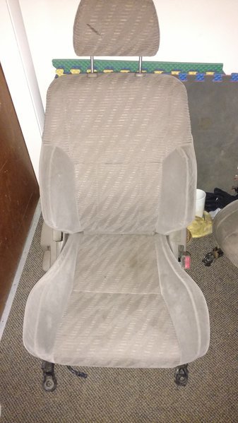

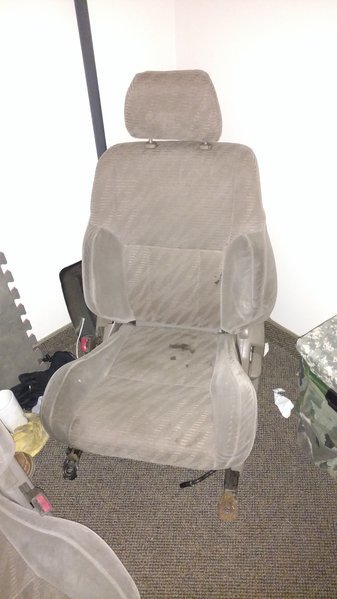

    Couple of pics on the seats. One of the wings is crushed a bit on the driver's side seat but overall they're not bad.

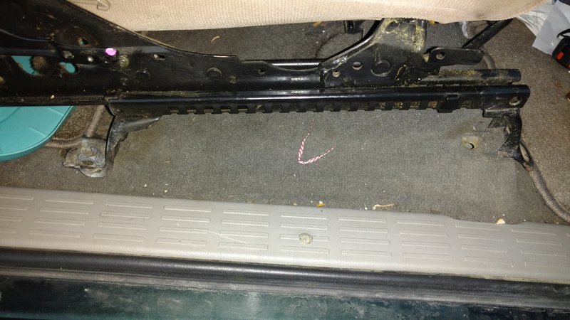

  18. Feb 19, 2017 at 2:59 PM
    #38
    SolitaryNomad
    SolitaryNomad [OP] Well-Known Member
    Sep 29, 2016
    #198524
    178
    Eric
    2003 Tacoma TRD Offroad
    None (yet)

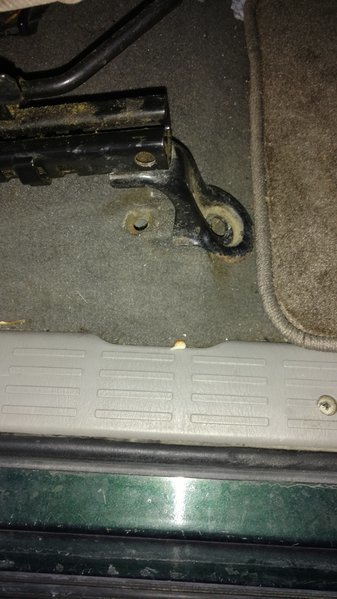

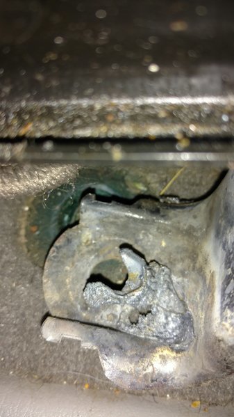

    The road so far: clearly I'm doing something wrong as only 2 of 4 holes line up.
    Do I legally even need a front seat? I kind of like having empty space there.
    I could probably grind the brackets off the 4runner seat rails and then bolt the Tacoma brackets on.

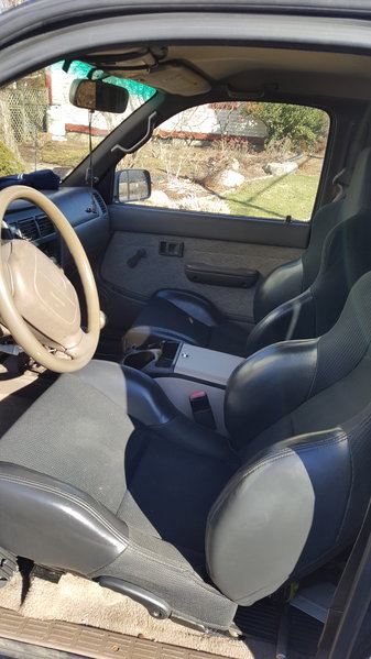

    Srt4 seats from neon i grabbed off Facebook marketplace for 100$

    Nice find, how'd they align?
