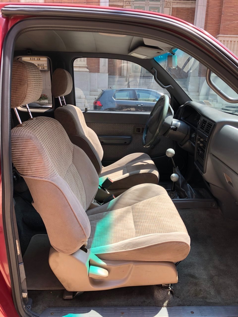

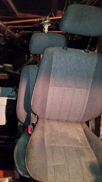

    When I had my old 4 runner seats they wanted 500 a seat to completely redo and the Toyota fabric
    is not able anymore.
    I would call the number on the video and ask for photos, it will be hard to find seats with less miles than these. I’m betting the seat are the 4runner style buckets and not the generic buckets.
    Here are the two different types. I had both of these and the ones with the bolsters were a lot better
    GQ7227[QUOTED] likes this.

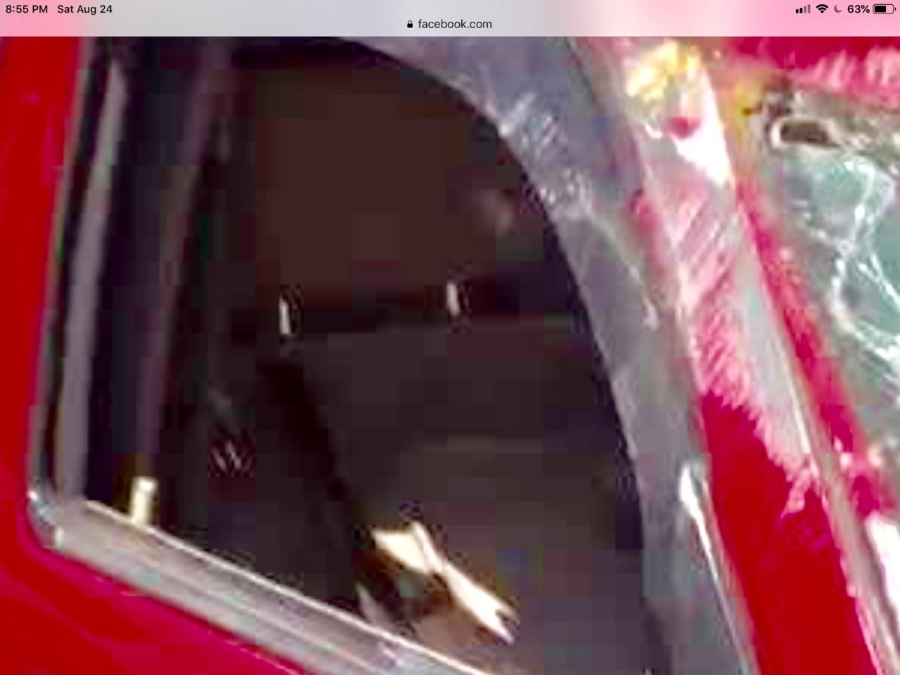

  13. Aug 25, 2019 at 6:50 AM
    #93
    GQ7227
    GQ7227 mw survivor
    Dec 6, 2018
    #275019
    29,298
    J A Y
    i cannot find any contact info on that either, i may be overlooking something though
    look like truck was totaled in a rollover?
    1:46 into that video shows it is a PreRunner and I don't see a limited badge onit?

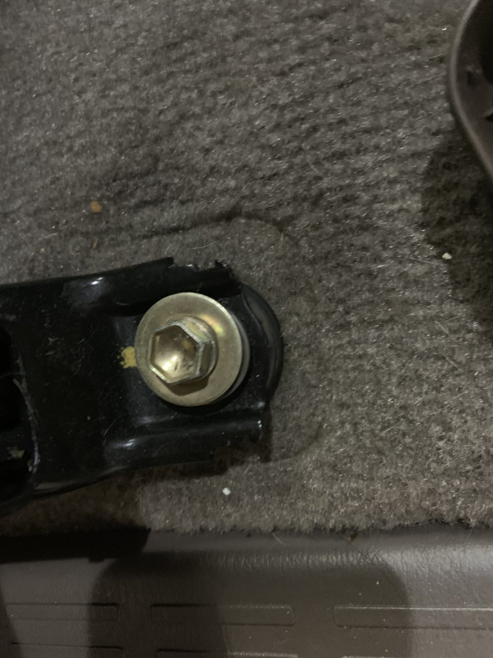

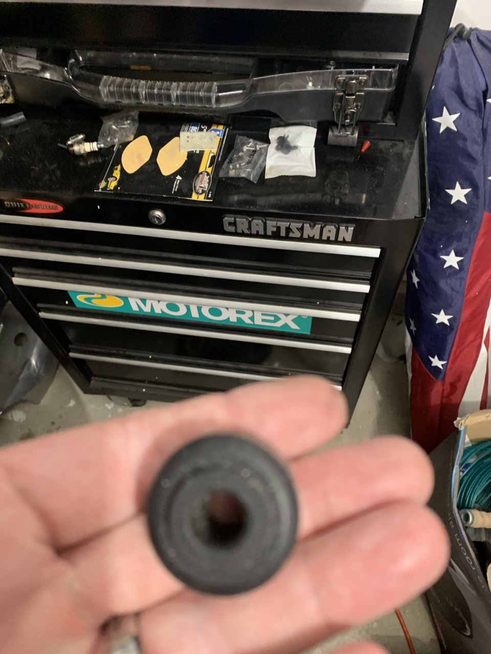

  18. Aug 25, 2019 at 5:59 PM
    #98
    Luv my yota
    Luv my yota Well-Known Member
    Aug 27, 2017
    #228278
    965
    00 turd lift 33's
    Kings,total chaos uppers, Deavers, JBA headers, Borla exhuast, engine mods, DC power 270 amp alt, 2k watts of sound, gps alarm.
    I’ll post pics there is two ways to fix this issue that @GQ227 was asking me about one is using energy suspension bushings under the seat rail where the factory one tears. The other is a maybe for some guys there is a ring bushing for the rear of the seat that essentially needs to be exactly like stock and if you have a pep boys around you then you have to buy one from a company called help, the bushing is too big but fits, fwiw. The squeak is from a torn seat bushing and it’s bugged my friends and I w/our tacos for years until I found the fix then my friends made different versions of it because of availability.
    GQ7227 likes this.
  19. Aug 25, 2019 at 6:10 PM
    #99
    Luv my yota
    Aug 27, 2017
    #228278
    965
    00 turd lift 33's
    A0A6ADEA-7C18-4536-BCF7-5E27632A7275.jpg EF06C372-6C90-463F-AB56-99CEF81FA0E9.jpg Here’s a pic of where and what I’m taking about I wound up grinding the lip off of the bolt sleeve and bolted through a decent poly bushing from energy. This will stop that annoying squeak. Btw this required throwing away the trashed bushing that was there and torn.
