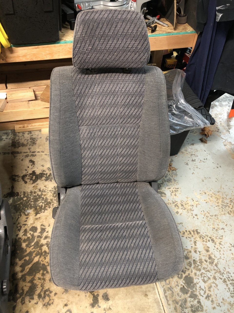

    I just picked up some front seats from a 1992 4Runner and I want to put them into my 1999 Tacoma has anyone done this swap before? If so what was needed?

    4 runner seats, storage cubbies
    Will not work
    Unless you swap the tracks over.
    Different bolt pattern
    95.5-2004 tacos have a unique seat pattern for some odd reason.
    There's a bunch of other threads about the swap, just search for em.

    I figured it wouldn’t be an exact fit I don’t mind modifying just seeing if anyone else has done it and what it took

    It's too bad your not 2nd or third gen, literally all the same except for a few caveats with regular cab seat sensors.and 4runner is compatible with more adjustment.
