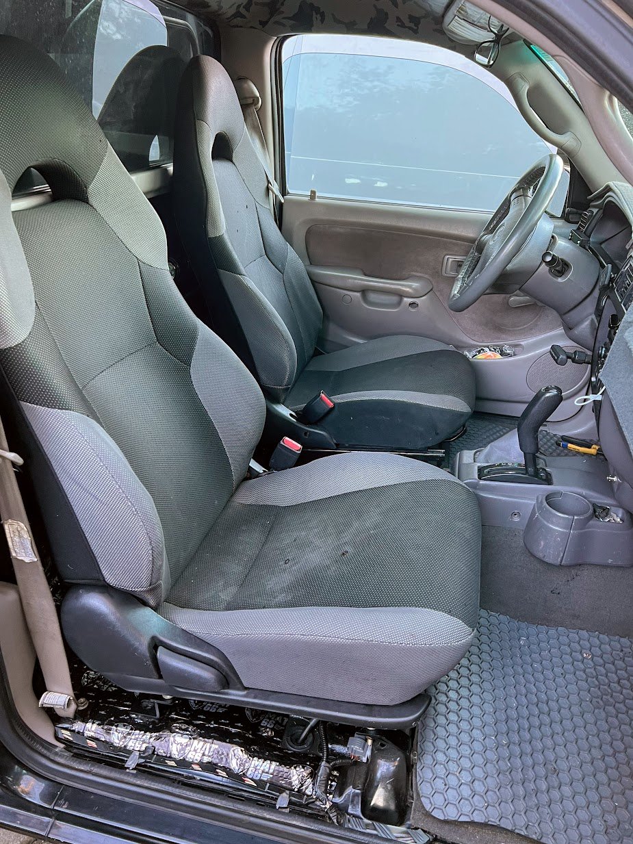

    I found a set of 2004 Celica seats at the junkyard, and used Corbeau brackets to install them.
    I have a single cab 2004 PreRunner.
    $150.

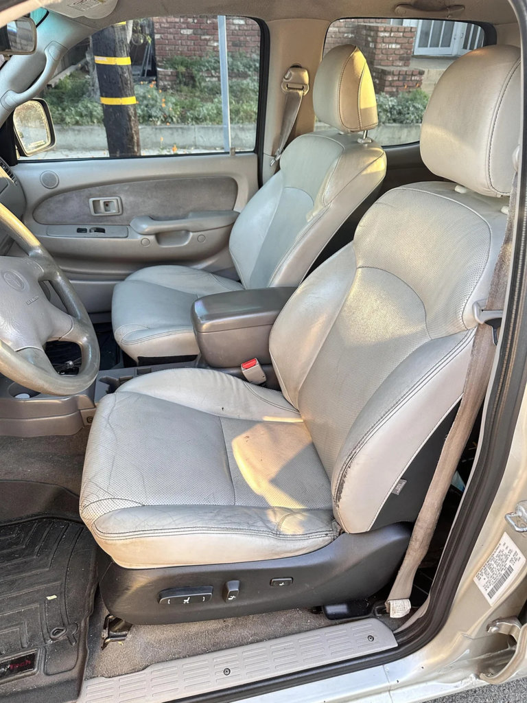

    Picked up this pair of 2009 Lexus IS-250 seats on marketplace for $200. They have seat heater and blower functions but I only isolated power to the seat motors for now. The base is definitely thicker than stock seats so I’m sitting higher up, but I’m 5’ 9” and still have about 5” above my head to the ceiling of the cab.
    I chopped off the legs off the lexus seats with an angle grinder and bolted on the legs from my stock seats (I don’t have a welding machine).

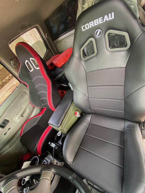

    Installed Corbeau seat brackets and Corbeau Moab seats replacing the original bench seat. Really like these seats, took a couple thousand miles for the seats to break in, very nice now.
