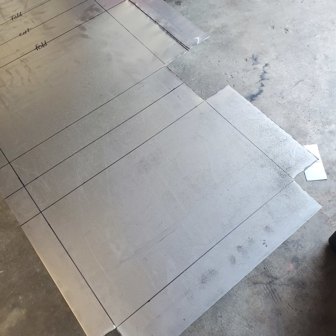

    I gotta go back to work.
    I'm building tool trays for my fixer upper tool box I just got for my Tacoma - I just got a new job...
