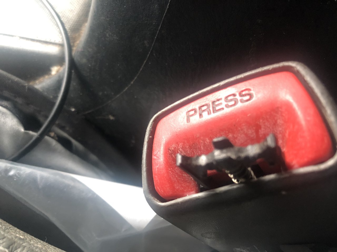

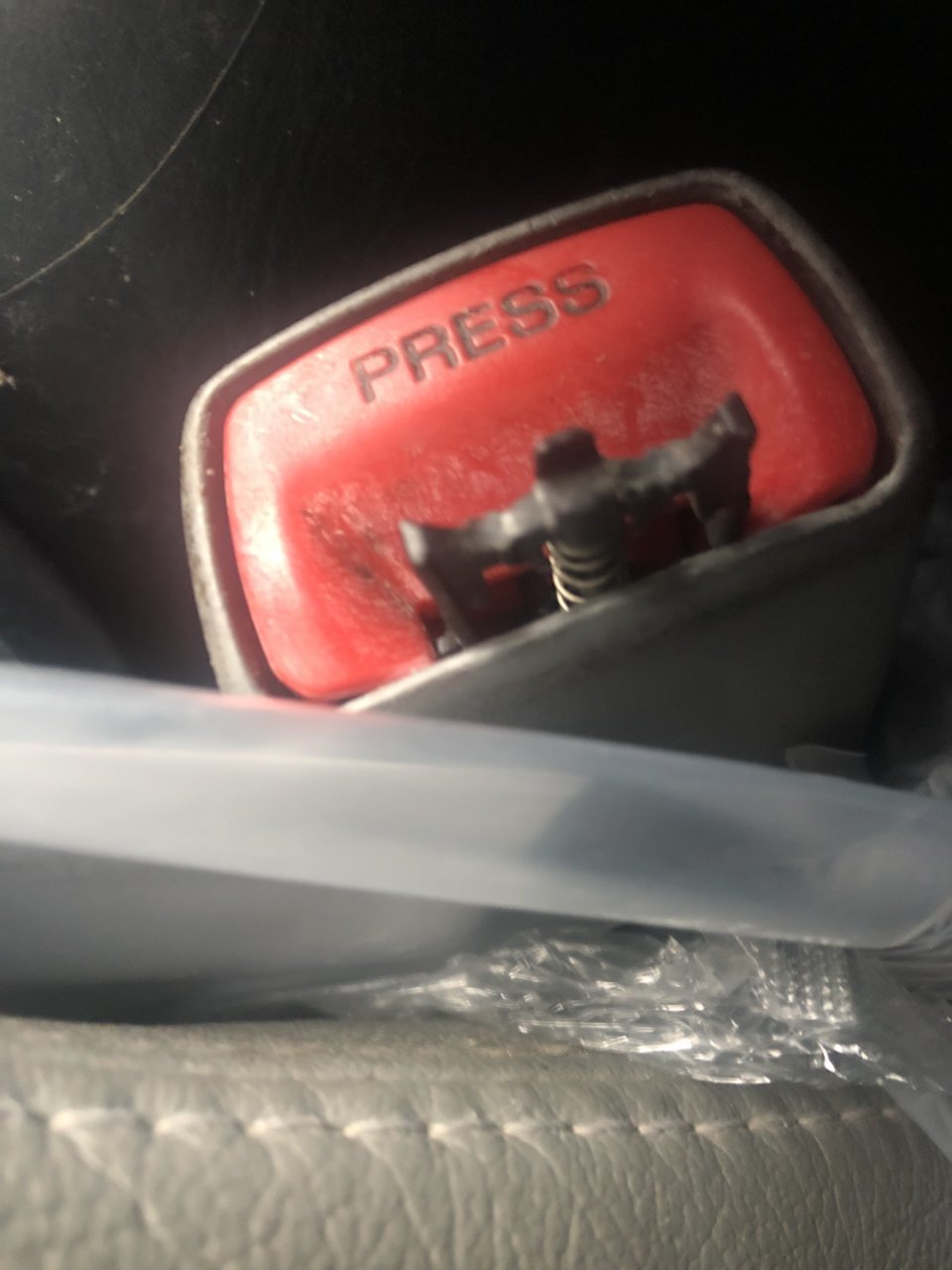

    Went to buckle up after a day of work and the little black piece that is pushed into the receptacle by the buckle was popped out and wouldn’t go back in.
    Any insight on how to shove this little guy back in?

    Replace.
    Something caused the part to dislodge. Do you know the cause?
    If you manage to "push it back in", will it stay in?
    Will the latch hold in an accident?
    Do you want to gamble serious injury or worse on your "fix"?

    It's best not to attempt repair on stuff like that, replace it and keep yourself in the seat. Don't be like that guy in the jeep video on the beach
