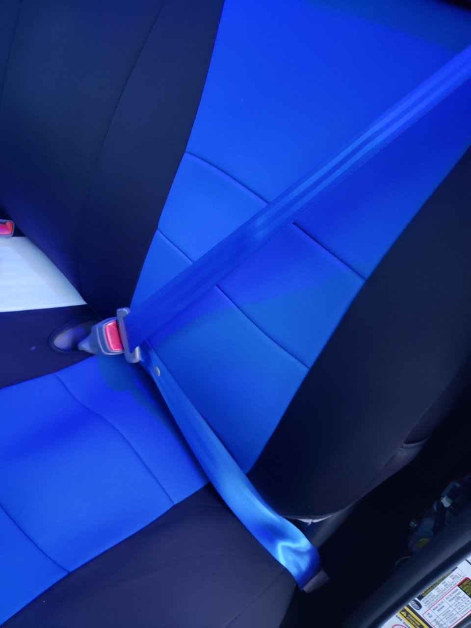

    I sent mine into Safety Restore after the passenger side locked up completely. It took them 5 days, I got to pick the color belt I wanted, they fixed the issue, cleaned all the OEM parts. It was $75 per belt.
    swellcat, CS_AR and GQ7227 like this.
