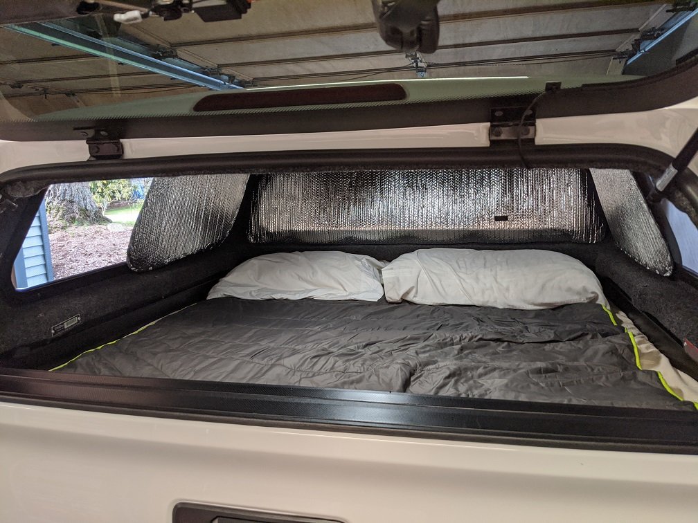

    I'm 6ft and large, and I can get away with sleeping diagonally. It's not a luxury experience, but it gets the job done and nothing beats waking up in the morning and immediately hitting a hiking trail without any real teardown. Not pictured are the foam mattress, Reflectix window covers, and bug netting for the tailgate and front window passthrough when it's warm enough. My memory foam mattress is only 3in and doesn't quite cut it, so I'll buy investing in a much thicker custom mattress next year. I also attached cargo netting to the ceiling to hold the aforementioned items, as well as dry out clothing. Boat dehumidifiers rounds out the setup.
    I've literally never used a circular saw or applied carpet to something before, and I was able to pull off a pretty seamless job. If I can do it anyone with enough motivation can.

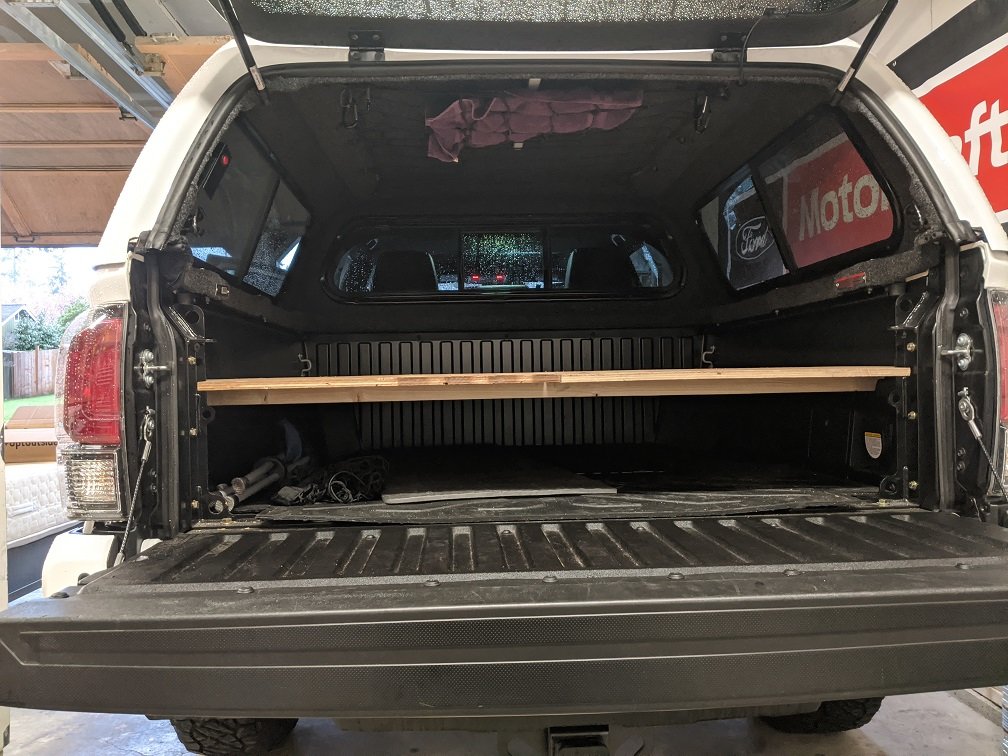

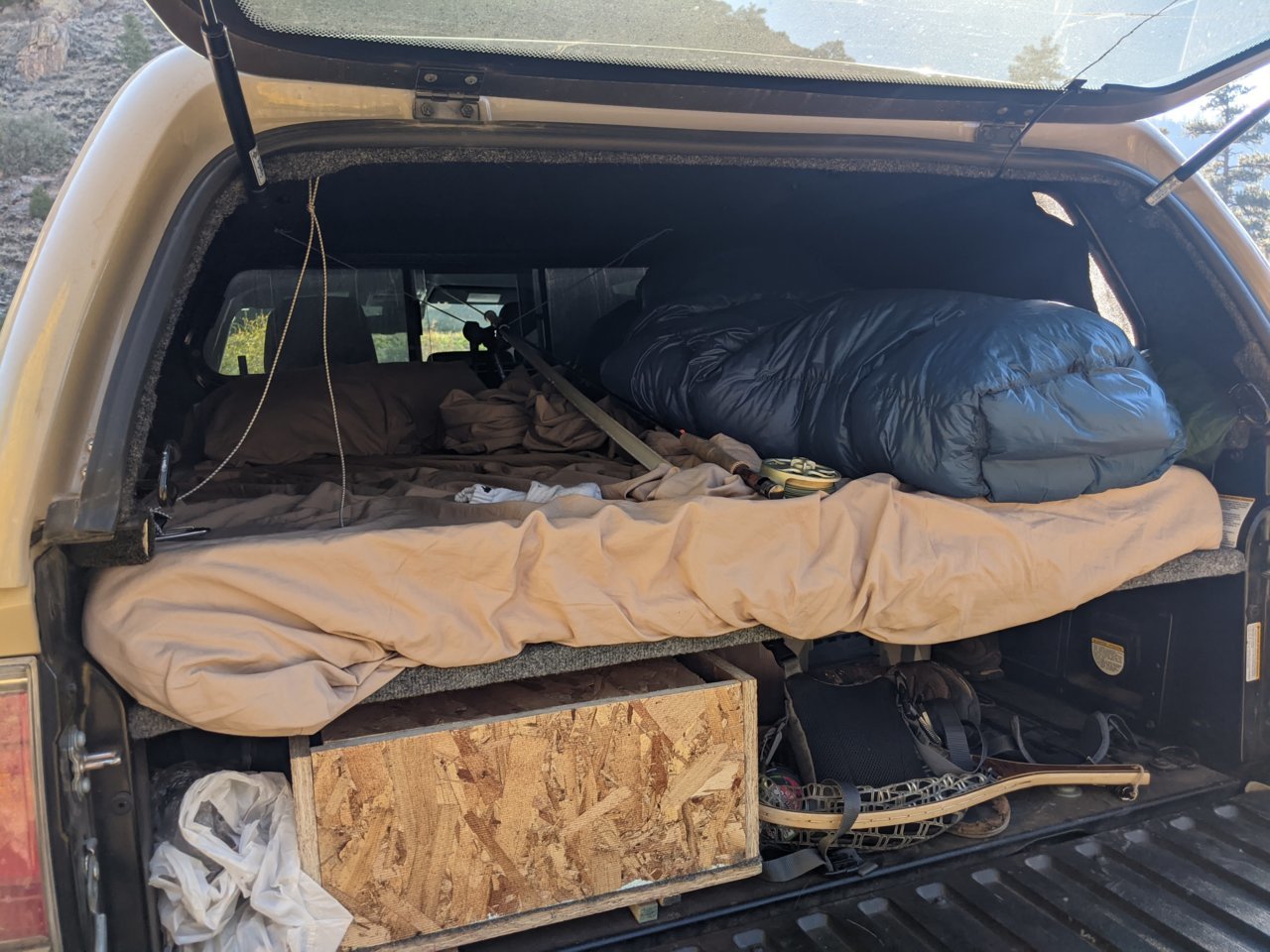

    Just some 2x4's cut to fit in the slots, 4 total. Nothing else besides that, and it only rests on the 2x4's. I traced a cardboard pattern to mark out the cut at the tailgate end, but once you get past that area it's straight.
    Flats are 2 pieces of plywood (I figured stiffer than OSB) covered in marine grade carpet that is affixed with staples and 3M spray adhesive. I painted everything in several layers of Kilz primer for mildew resistance.
    I'd get you more pictures but I just had knee surgery and not really in any shape to be moving the track and lugging around lumber!
    Edit:
    Found a few more shots for you. Pre-painting, and finished setup. I now sleep with my head towards the tailgate and my feet propped up in the corner. Gains me the few extra inches I need to be a lot more comfortable. Lots of pillows. I always keep my ice axe under there to help retrieve things I bury way up towards the cab.
