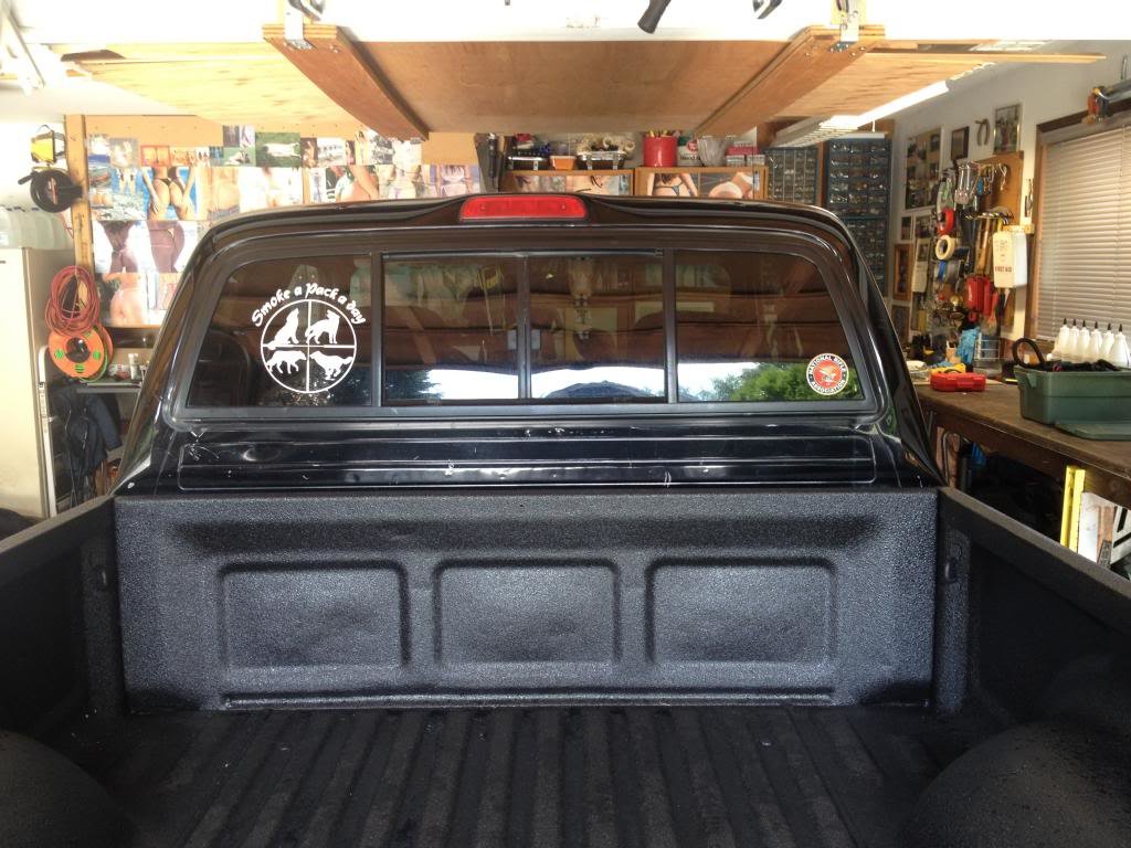

    New Line-X Bedliner and a few decals
    Remove Canopy and give her a full Wash and Detail

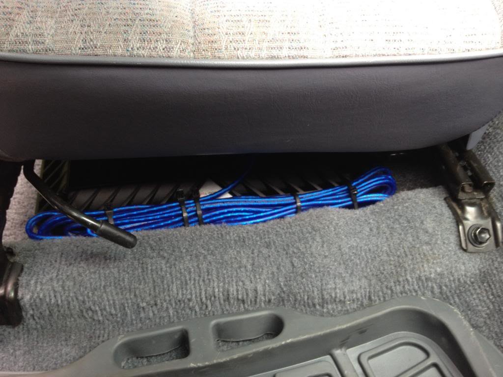

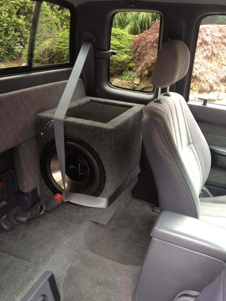

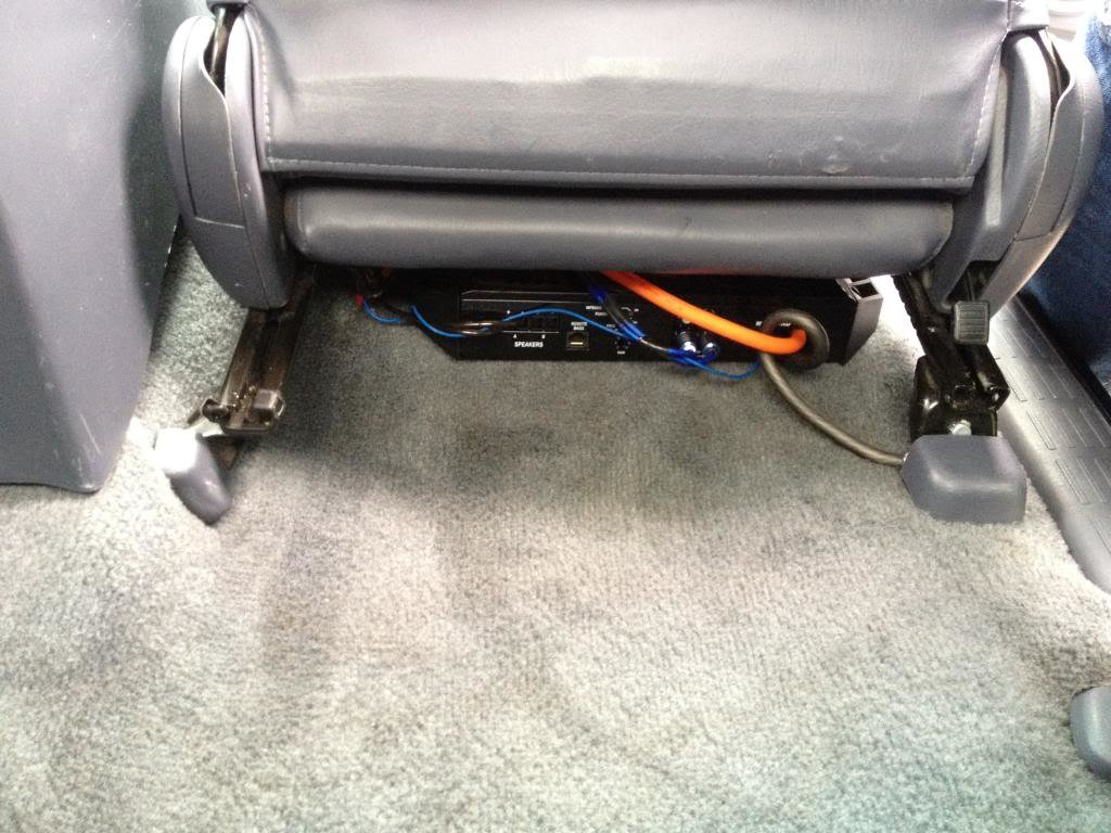

    Installed a new Premier deck
    Amplifier underneath the passenger seat
    Front
    Back
    Diamond 12" Subwoofer

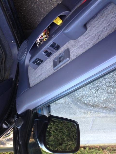

    My Dad installed new Power Mirrors as a Xmas Present

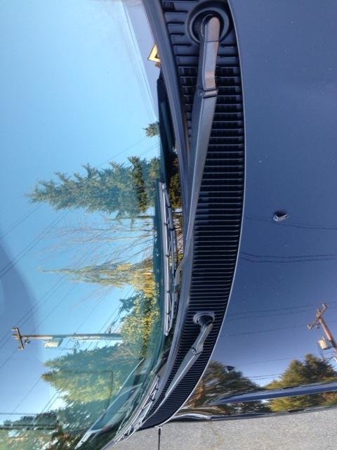

    Removed and Painted the Windshield Wiper Plastic

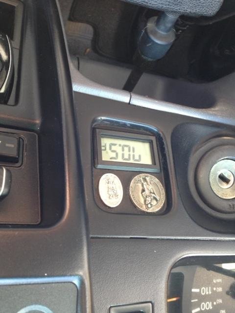

    Installed a Temperature Gauge

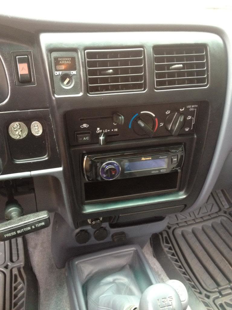

    Installed New Gauge Cluster LEDs
    A/C Panel has lights I just don't have them in for this photo

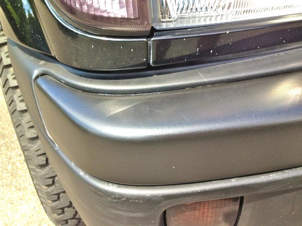

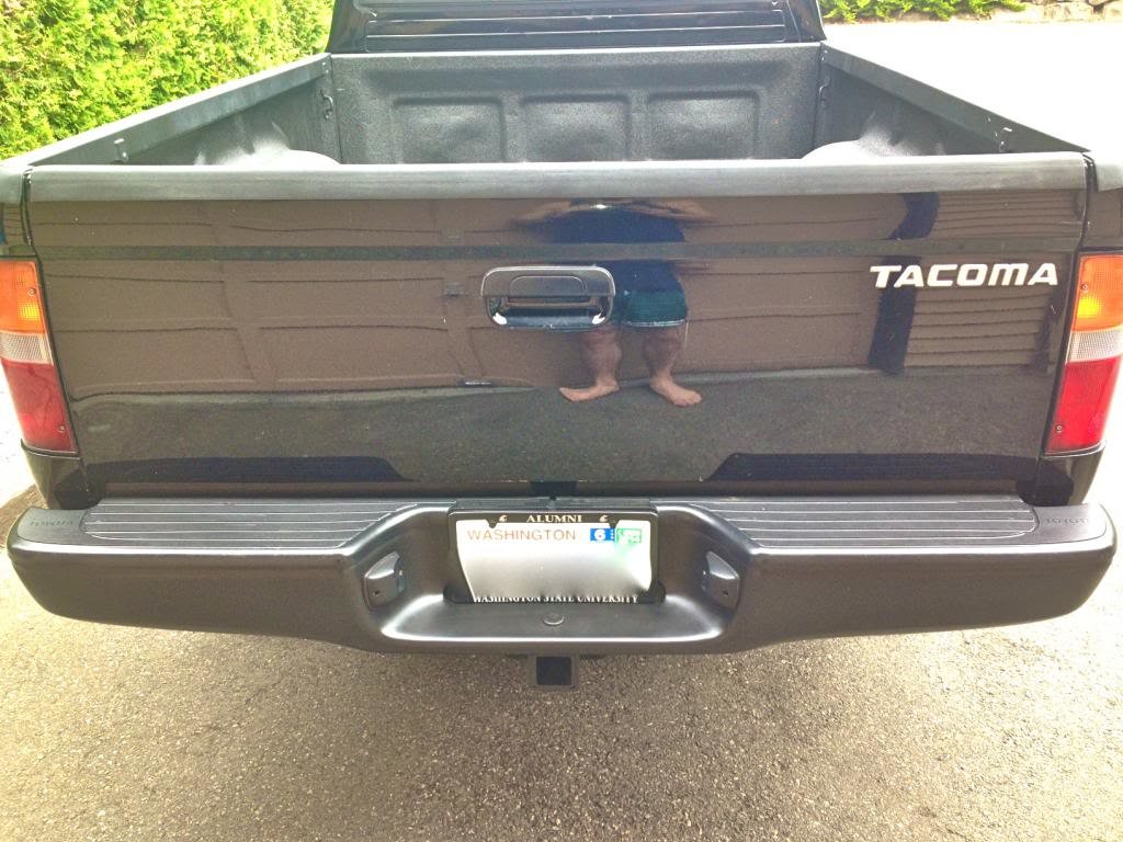

    MUST DERP ALL CHROME

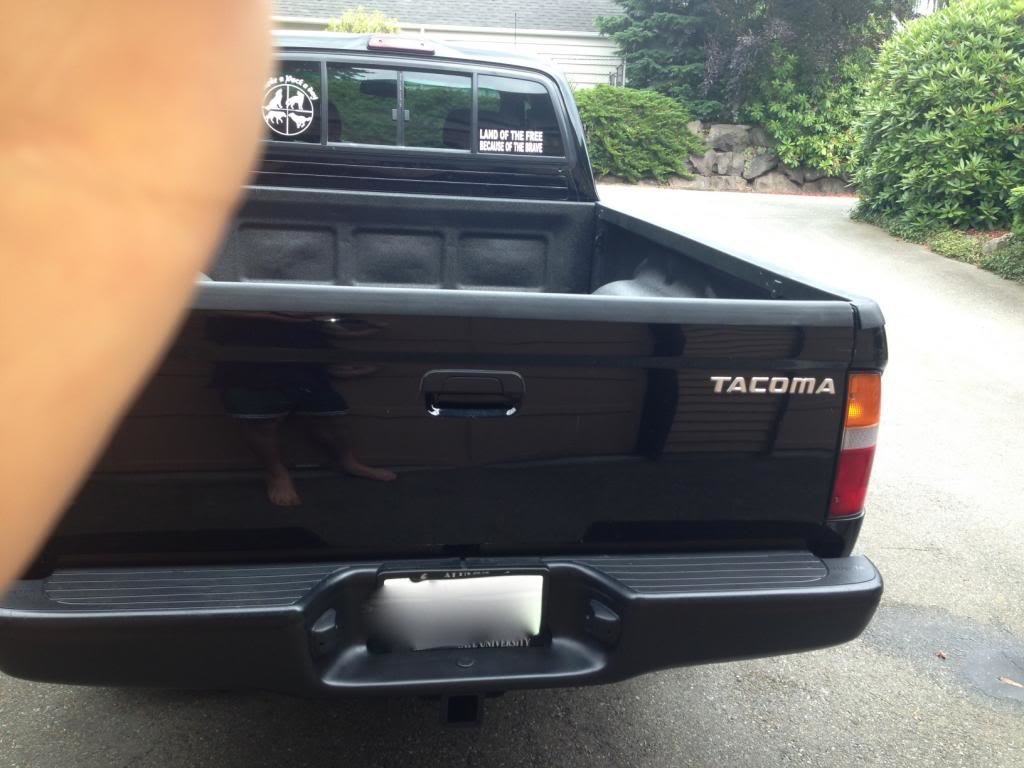

    De-Badged the Tailgate​
    Shot the 3rd Brake Light with 1 Coat of Tint & New LED Bulbs
    Hard to see with the glare, but you get the idea, just a little darker.

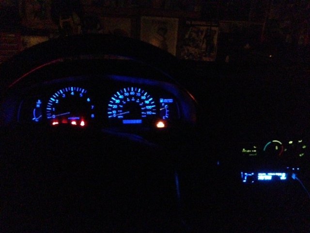

    Change Out LEDs
    Went from Blue LEDs
    Gage Cluster has 4 (194 LED Bulb - 5 LED Wide Angle Wedge Base)
    A/C Panel has 2 (74 LED Bulb - 1 LED Wedge Base)
    Now switched out to ALL white LEDs
    Gage Cluster has 4 (194 LED Bulb - 5 SMD LED Wide Angle Wedge Base)
    A/C Panel has 2 (74 LED Bulb - 1 SMD LED Wedge Base)

    Nice looking truck. I love the first gens. How was "derp"ing all the chrome? Did it come out smooth and even? I want to do it to my 2013 bumpers, but I'm scared it might come out uneven.

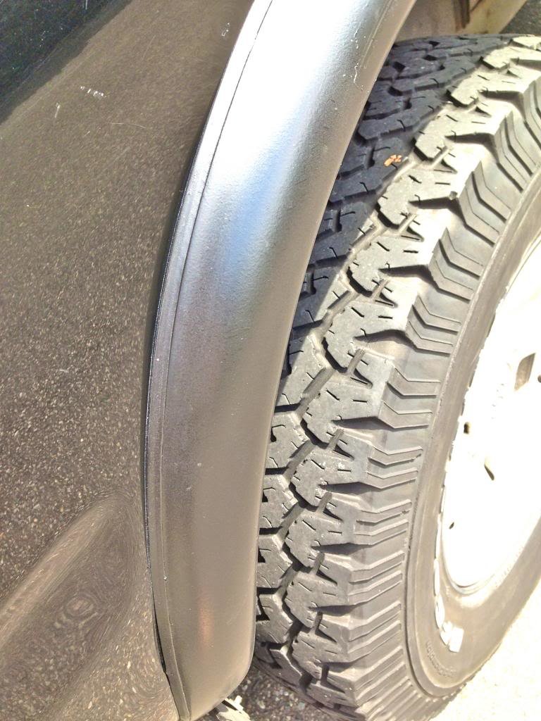

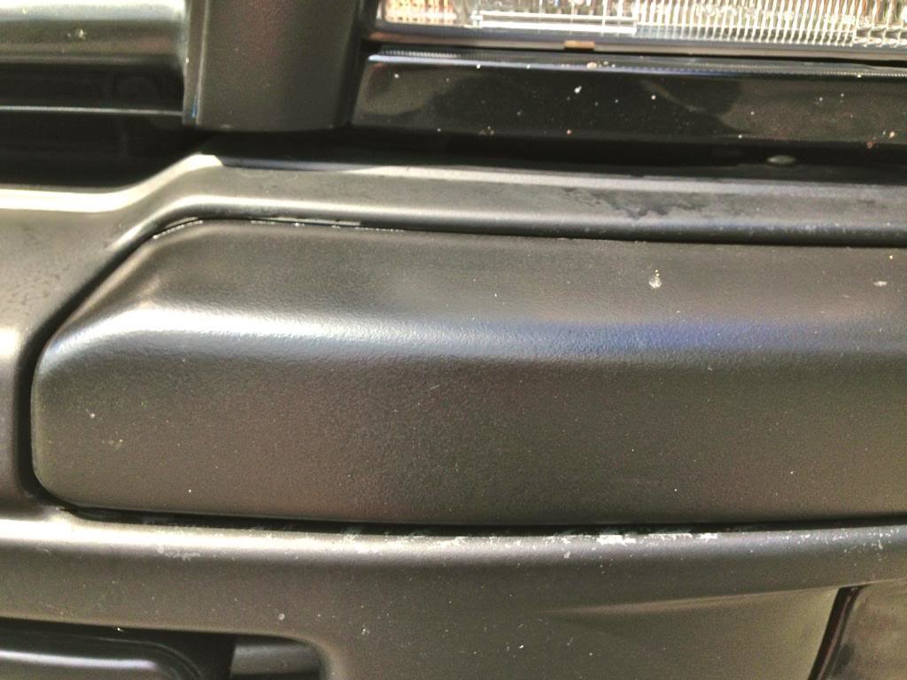

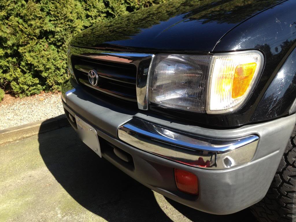

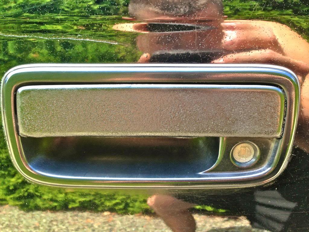

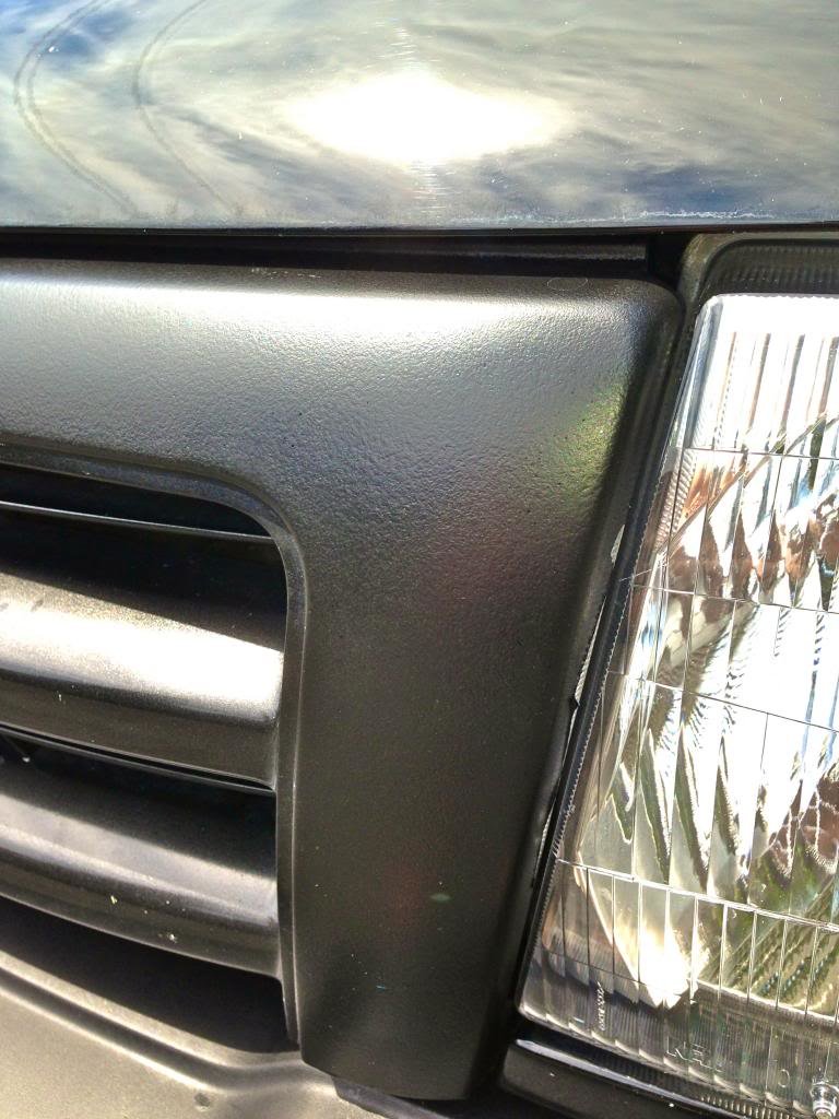

    Derping the chrome was a little time consuming since each piece took 3-4 (thick) coats, but it turned out VERY good. I think the trick to derping is prep prep prep, along with that make sure the 1st coat is sprayed evenly and is thick.
    I can take a couple of up close pictures for you tomorrow...? I would go for it though, and if you end up not liking it you lost $6 on a cheap mod and can just peel off the rubber.

    Yea that would be great. I would like to see an up close picture. I've been meaning to do it for a while, but I hear mixed reviews about it.

    Yeah I'm gonna stick with that for now. I just think getting some 15x8 pro comp rims would look a little funky on a stock set up. I'll just have to search for some photos of others who have it so I can compare..
    Here ya go, snapped a few for you. Some definitely turned out better (rear bumper, front bumper [2] chrome pieces/grill outline, back fender flares) than others (taco front grill emblem, passenger handle)....
    Rear Bumper:
    [2] Front Chrome Bumper Pieces -- keep in mind they are dirty since I haven't given it a wash for a while:
    Grill Outline:
    Fender Flare:
    Door Handle:
    Hope that helped :cheers:

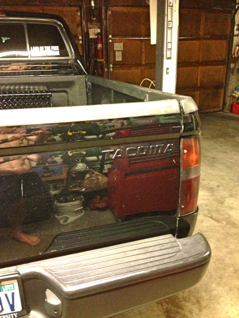

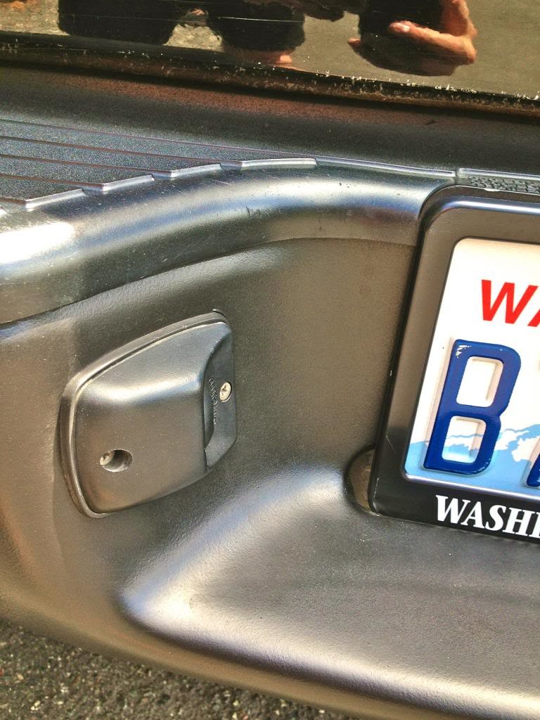

    Blacked Out the 'Tacoma' Tailgate Badge​
    Before:
    After:
    Ehhhh I kinda liked how the badge 'popped' before but oh well this'll do for now
