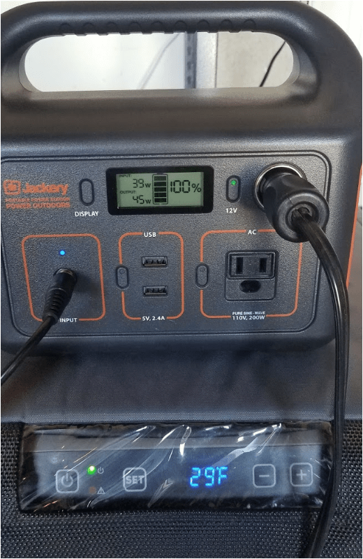

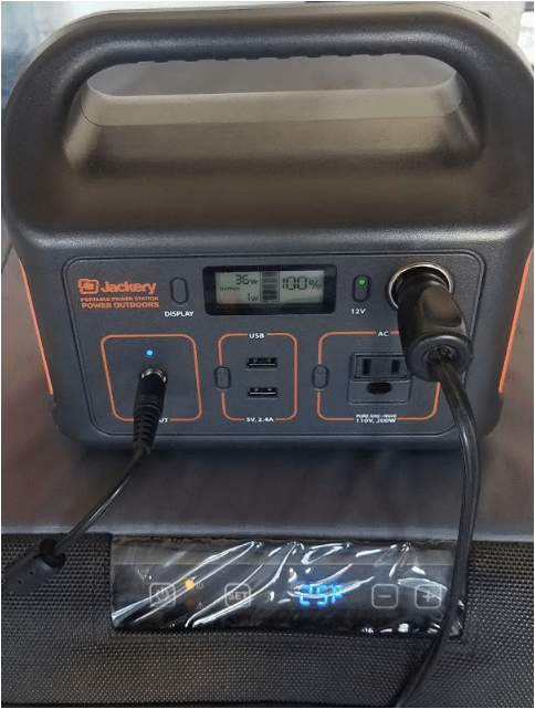

    We had a power outage last night so I had to transfer some food to my dometic and connect it to the jackery. We filled it with our frozen food and went to bed. In the morning the fridge was off and the jackery was off even though it still had 88% of charge left. This tells me that the frozen food was cold enough that the fridge didn't have to turn on. And after some time with no draw the Jackery must have shut off too. Just thought I'd report back. This info might be useful to some of you.

    Keep in mind those jackery’s have, I believe, a 3 hour shutoff with no draw. The explorer 1000 is 12 hours.

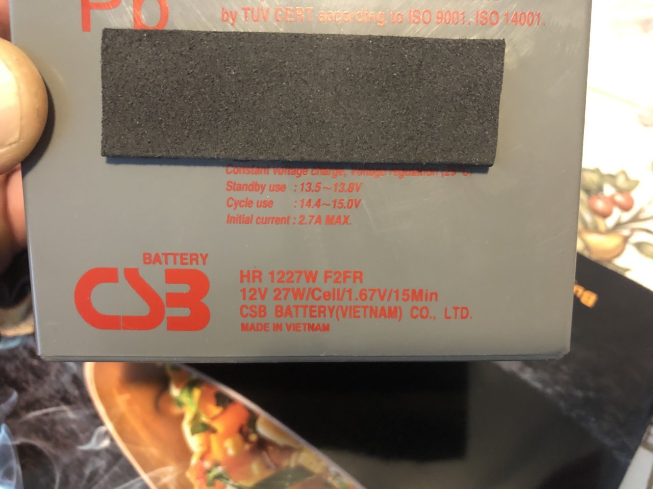

    Can any battery nerds tell me what the amp hour of this battery is? I tried to read the website but its jibberish to me.
    what I do know is 8 of these in parallel ran an empty dometic cfx45 for 40 hours @ 4 deg C with Room temp was 23 deg or so. (Rough translation fridge @40deg F, room @ 75deg F ish)

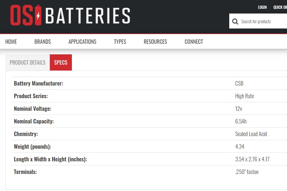

    Per a couple sites I found, it appears that battery is 6.5AH.

    Going to add 2 more cells, so 10 in total. Would that make 65ah? (probably a dumb question)
    They were out of a back up power system, 10 cells in series making 120volts. There was half a pallet of them , tech said they were all being recycled and let me have one.

    yeah, should be 65AH. Depending on how old and how used they are, that could obviously be less. But as long as they are working for you, sounds great!
