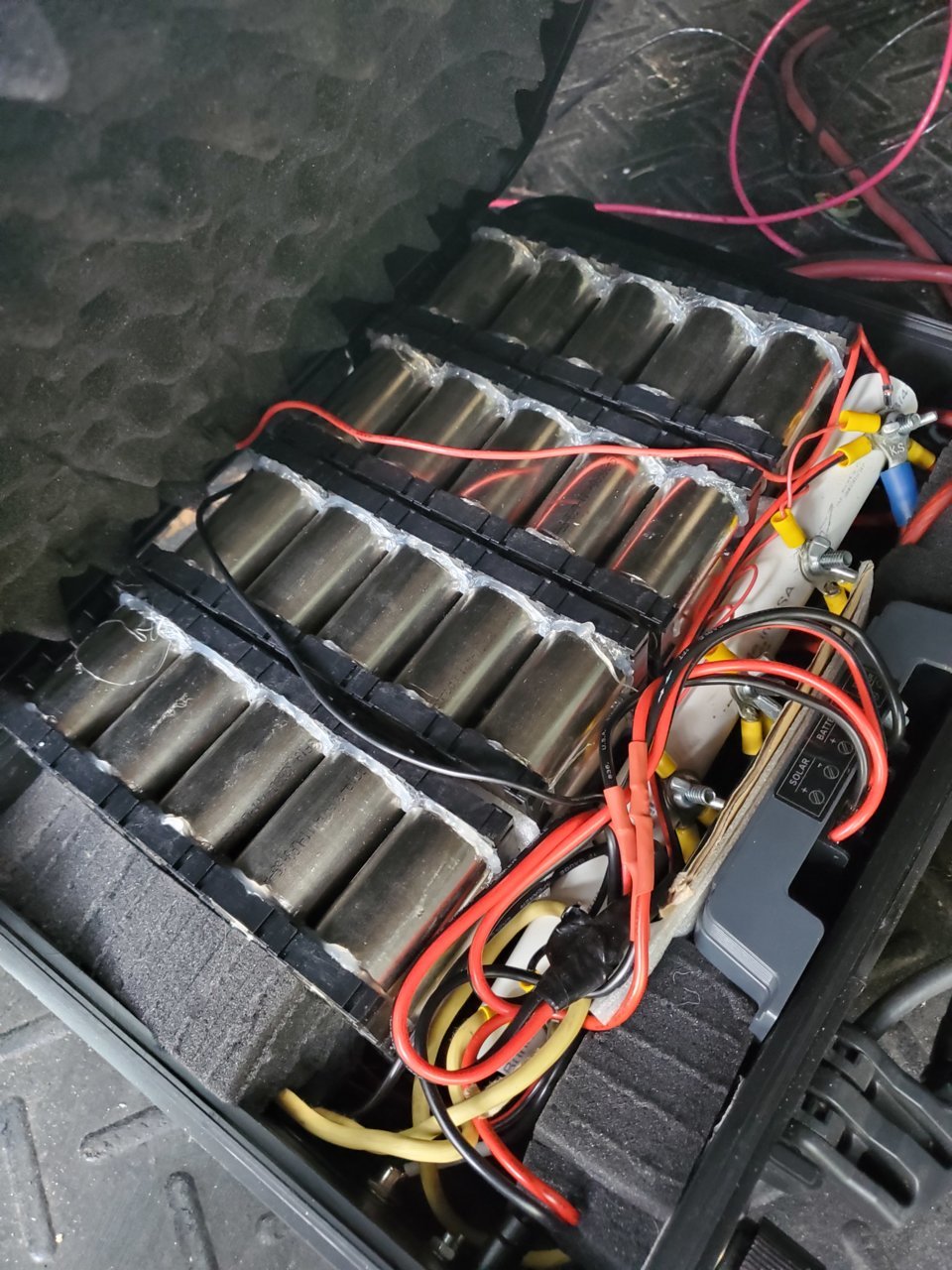

    For backup power for my refrigerator, and as a portable battery with 12v and USB charging ports for camp and my hobbies (drone charger and drywasher power source), I made this 400Wh portable auxiliary battery for less than $100. I have a two battery system for my truck, but also ran 4ga wires to the bed where I keep this while traveling:
    https://www.tacomaworld.com/threads...table-power-battery-for-less-than-100.631427/

    Why did you need the boost converter?

    Yeah, I didn’t include a comment about the extras...
    With the boost converter, it’ll run my refrigerator or my drone chargers with the battery down to 9+ volts without turning off (battery saver protection), otherwise they only run when they’re getting more than 12 volts. I know some refrigerators have programmable battery saver circuits that allow you to run lower than 12 V, so you don’t really need a booster with one of those.
    With my charger bolted outside of the box, I can recharge the battery with my solar panels, my alternator or through the auxiliary battery under my hood with it. And when I’m parked, it will keep running the refrigerator, as it’ll keep charging the smaller battery from the auxiliary battery - so it essentially doubles its capacity as well.

    Hmmm. All the fridges I’ve seen run down to 10.8v which about as low as you’d want to take an AGM. But maybe I’m wrong.

    No, you are right. The thing is my drone battery charger does not work below 12v. That’s typical for the cigarette lighter plug chargers for DJI drones.
    Maybe my refrigerator is different, its not a regular brand, it’s a inexpensive Chinese built Amazon one with wifi control (cool, as I can control it and monitor the temp in it on my phone from the cab), but it does have a programmable shut off voltage for the battery saver. I think the lowest it will go is somewhere between 9 and 10v. Also, that small battery is a deep cycle gel cell, not AGM, so I can run it down safely.

    I’m not a battery expert, so take this info as you will. The description of the battery linked in your build thread say that it is a deep cycle AGM. Either way, deep cycle or not, it should still only be discharged to to about 50% state of charge which is approximately 12v. You can completely discharge it to 10.5v but you will degrade the battery faster. After 10.5v you have pretty much gotten 99% of the energy out the battery and you are only further damaging it. It’s a pretty inexpensive little battery so maybe that’s not a huge concern.
  19. Jul 12, 2020 at 6:11 PM
