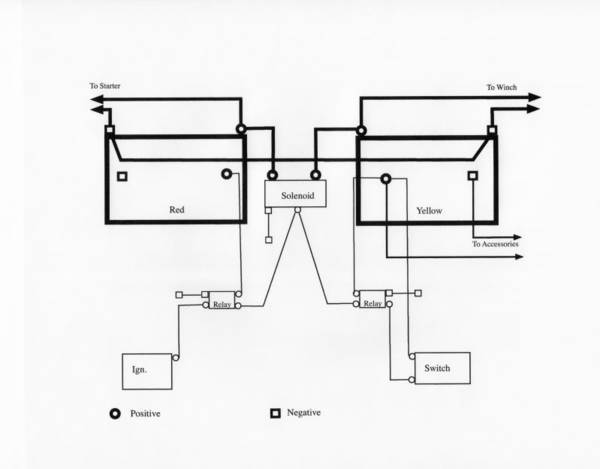

    how you guys fuse a second battery?
    battery>>>>>fuse>>>>>>>>>>>>fuse>>>>battery>>>>fuse>>>>>>>amp

    Here is a picture I found for you.

    What are you wanting to do with the second battery? How you answer that depends on how you setup your battery.
    I'm going to assume you want this for stereo reasons? If so and you just want to use it only for the stereo then you'll want this.
    http://www.amazon.com/Stinger-Amp-Battery-Relay-Isolator/dp/B001HC6UJ0

    Batteries in my diesel have NO fuse "between" them-Hooked up in parrallel-POS-POS Neg to Neg--Fused AFTER battery.

    yes for the stereo
