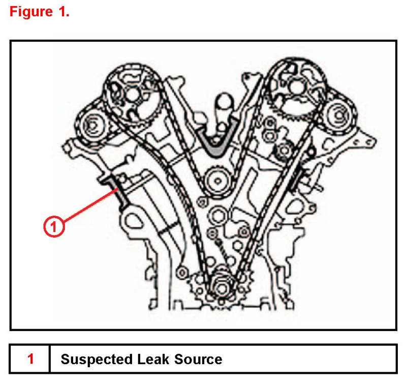

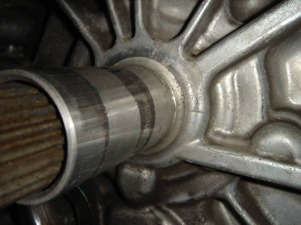

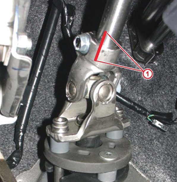

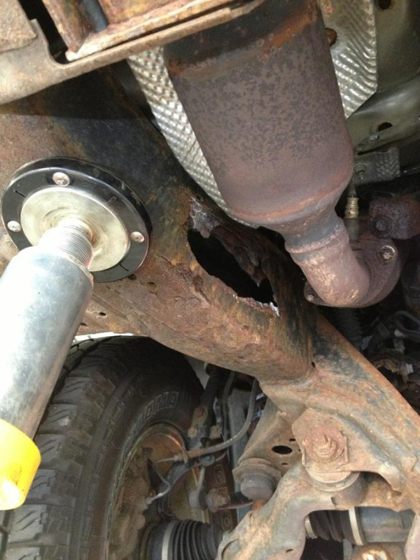

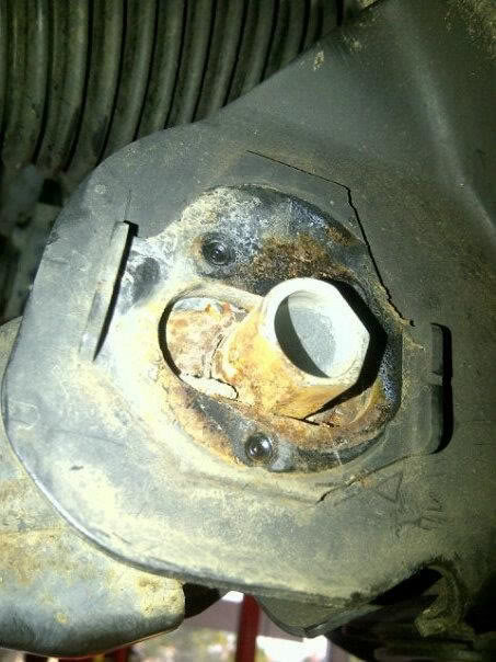

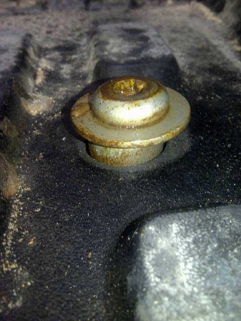

    Since working on Second gen Tacomas here are a few weaknesses I have observed.
    1. Steering Rag joint rattle on rough roads..bad design on intermediate steering shaft.
    2. Composite bed mount gets loose and wears out even though the bolts are tight.

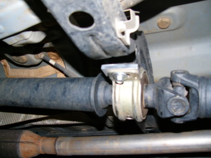

    3. Driveshaft wobble and center bearing vibration with lift and some stock trucks..very hard to get rid of. Also no grease nipple on sliding yoke.
    4. Oil leaks on timing cover of the 1GR-FE engine.
    5. Clutch noise on manual Transmission V6 models due to poor design of release bearing shaft...made of Aluminium and is eventually worn out by release bearing sliding on it...why Aluminium and not steel?? God knows.
    6.weak engine mount supports on 05 models. They fail causing engine to drop down on to front differential.
    7. Lower control alignment cam bolts tend to get frozen into bushing sleeve making alignment impossible.

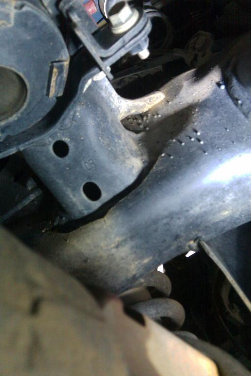

    8. Looking at a few second Gen Tacomas for export I have noticed many cases of severely rusted frames. Seems that Toyota hasn't fixed this problem yet.
    Most of these issues can be easily fixed..except for the rust!!
    Maybe others can add their observations.

    Yikes, what model year is that one with the rust?

    That's a 2005 I have seen 06s 07s and 08s like that. And 09s with flaking rust on frames.

    I've seen a few of the second gen Taco's with rust holes in them... it's a shame.

    Yeah, I've noticed some clank noise that seems to be from the steering shaft area on rocky roads. But I don't think it is a horrible-gonna-fail-sometime issue. The Gen I was the same.

    How the hell do you get rust that bad in Florida?

    the 6 speed makes my stomach churn. in this day and age, especially, there is no excuse for having a less-than bulletproof manual trans. that's why I bought one. my 92 5 speed was flawless when I got rid of it, the new one should last longer right?
    I thought it was discovered that aluminum is not a good bearing surface like 3 seconds after aluminum was discovered.

    I had issues with the intermediate shaft, and just had it replaced through warranty last Thursday. All issues resolved now. No more clunking/loose feeling in the steering. So glad that was the problem and its fixed now.

    had to replace my whole driveshaft because of vibes from a 3" lift, carrier bearing drop is keeping the vibes away now
