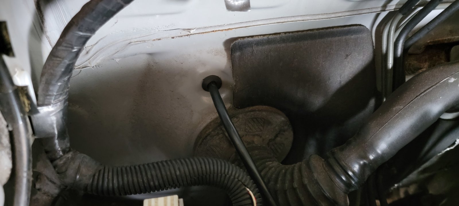

    Wanted to add my 2c since this was a total PITA but I got it done. I poked 2 holes with a flat head screwdriver in the standard firewall, then I taped the plugs to a flathead (the longest I had, not very long) and forced them through. Figuring out the right way to tape it and the right way to push them through was pretty difficult to be honest... but, I got it. I originally followed a youtube video where the guy inserted the wires around the side edge of the firewall grommet, but this was super unsafe since it could cut through the wires and it breaks the seal on the firewall. So I read through this forum and went with the flat head trick-- Thanks to TW. It feels much much safer and cleaner now.
