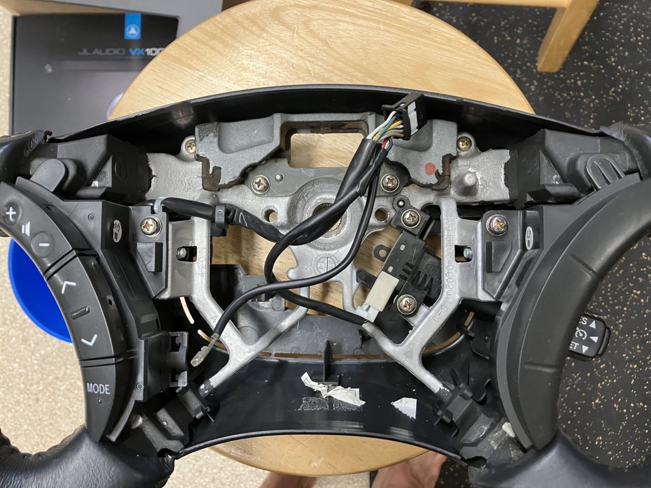

    Ok, I am confirmed to drive the 2005 north to the PNW on Wednesday the 20th. That decision bumps up priority on getting cruise control installed and working. I have good instructions from the kit I bought but may lean on the TW community for help, apologies in advance if I tag someone like @Empty_Lord or @Hayrider or @PennSilverTaco
    I do happen to have a leather spare wheel with audio controls and cruise stalk in a matching color and an airbag cover which almost matches. I’m a tiny bit tempted to try an entire wheel swap in the Tacoma but wary of the level of difficulty there. And I rather like the blacked out steering badge on the existing airbag cover which is the “no audio controls” style. Though maybe that piece can transfer over directly?
    Radio for now is stock and I have a black version inbound which may arrive before I leave, that should be a purely cosmetic change.

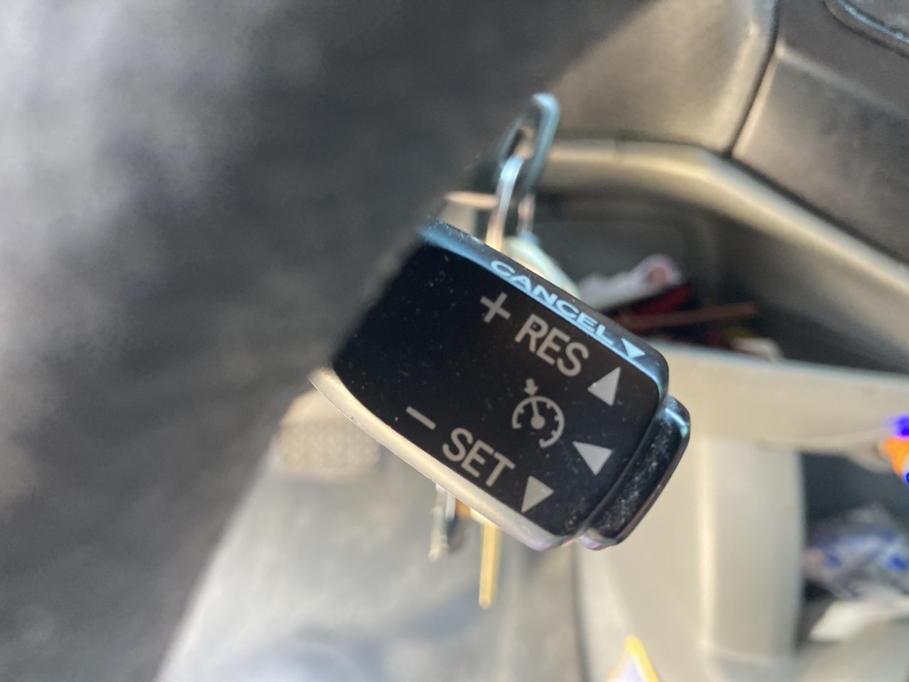

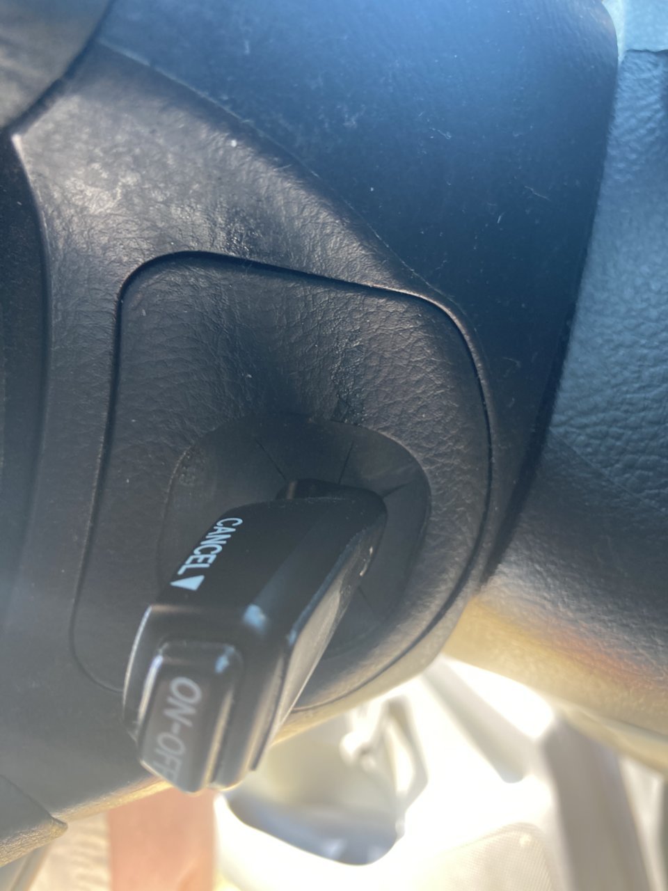

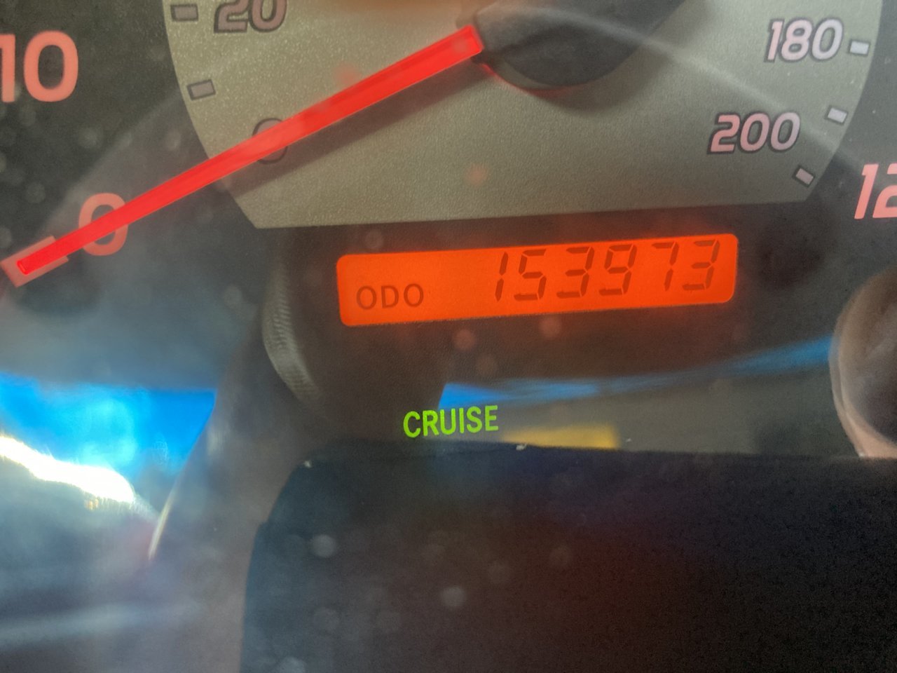

    I unfortunately did not oversee the installation of cruise control in my truck (big mistake). All I know is that the there is at least one additional wire that must be connected to the ECU, and if your truck is manual then another wire is required to connect to the clutch. My cruise control stall turned out to be defective, and I am currently running an OEM stalk that works great. My truck is a 2010; I heard that some older 2nd Gens may be prewired for cruise control, and all that's required is installing the switch. My system is not the least bit factory, but it functions like it is...
    5A4FF944-B485-4E3F-B80E-83FED2736C6D.jpg 81543A12-2DB3-4FB3-A754-4494A377594B.jpg B4AB4B4E-670E-4187-B4FD-EFDDB369E75B.jpg
    Up until last month, the cruise control was working intermittently; I am going to Syracuse for a huge car show in 3 days and I obviously wanted cruise control for that trip, so I acted on a theory and had my mechanic swap out the Rostra stalk for an OEM one I had lying around. Turns out that was the problem the whole time and the cruise control now works great!
    daveeasa[QUOTED][OP] likes this.

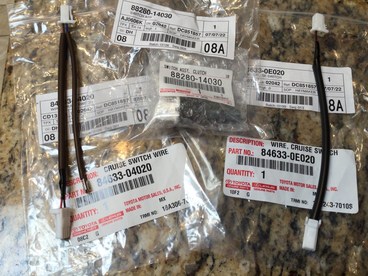

    1st. With all do respect “ALL” Tacoma’s come pre-wired for cruise‼️
    2nd. If you have a manual then you remove the clutch pedal stop and install the switch in the center of the photo below.There is a wire that plugs into to the switch that’s in the wires behind the left kick panel. The wire is easy to find sometimes and not so easy other times. It will have about a 1/4” wide piece of masking tape holding it to a bundle of other wires.
    3rd. Many say their Tacoma’s are not pre-wired because they don’t know you need to exchange and or replace a wire behind the airbag. Depending on the options the truck came with will depend on what wire you need to exchange and or replace! Either the one on the left or the right. I’m purchasing a base model 05 5 lug in Portland and driving it home on the 25th. So I purchased the parts to install the cruise for the trip home. I’m 99% sure I’m going to need the one on the left but my Toyota parts man said to take both just “in case”.
    4th. Oh yeah you need the OEM cruise control switch that mounts to the factory steering wheel. Sorry I don’t have that part number because I purchased a nice leather wrapped wheel and it came with the switch and the little cover with a hole & rubber flap the cruise control switch protrudes through.
    EDIT; Dave I just saw the photo of the steering wheel at the top of the page. If the wheel fits your truck you just need the clutch pedal switch. The wire with the metal connector with no insulation will plug into the horn.
    daveeasa[OP] likes this.

    Thanks for all the great background. I'm excited to get this party started. I have a kit with pinned wires. And I happen to have a little experience with these connectors. Already located the plug near the clutch and the kit I got has that switch. Just hoping to figure my way through the process since it's my first time even opening up the wheel. Definitely watched my share of videos though.

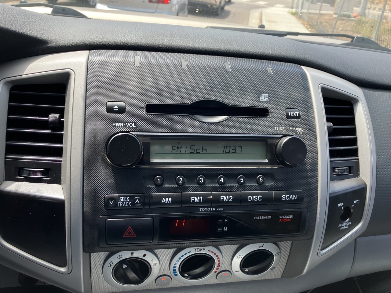

    Blackout radio in. Same as the silver but less ugly.
