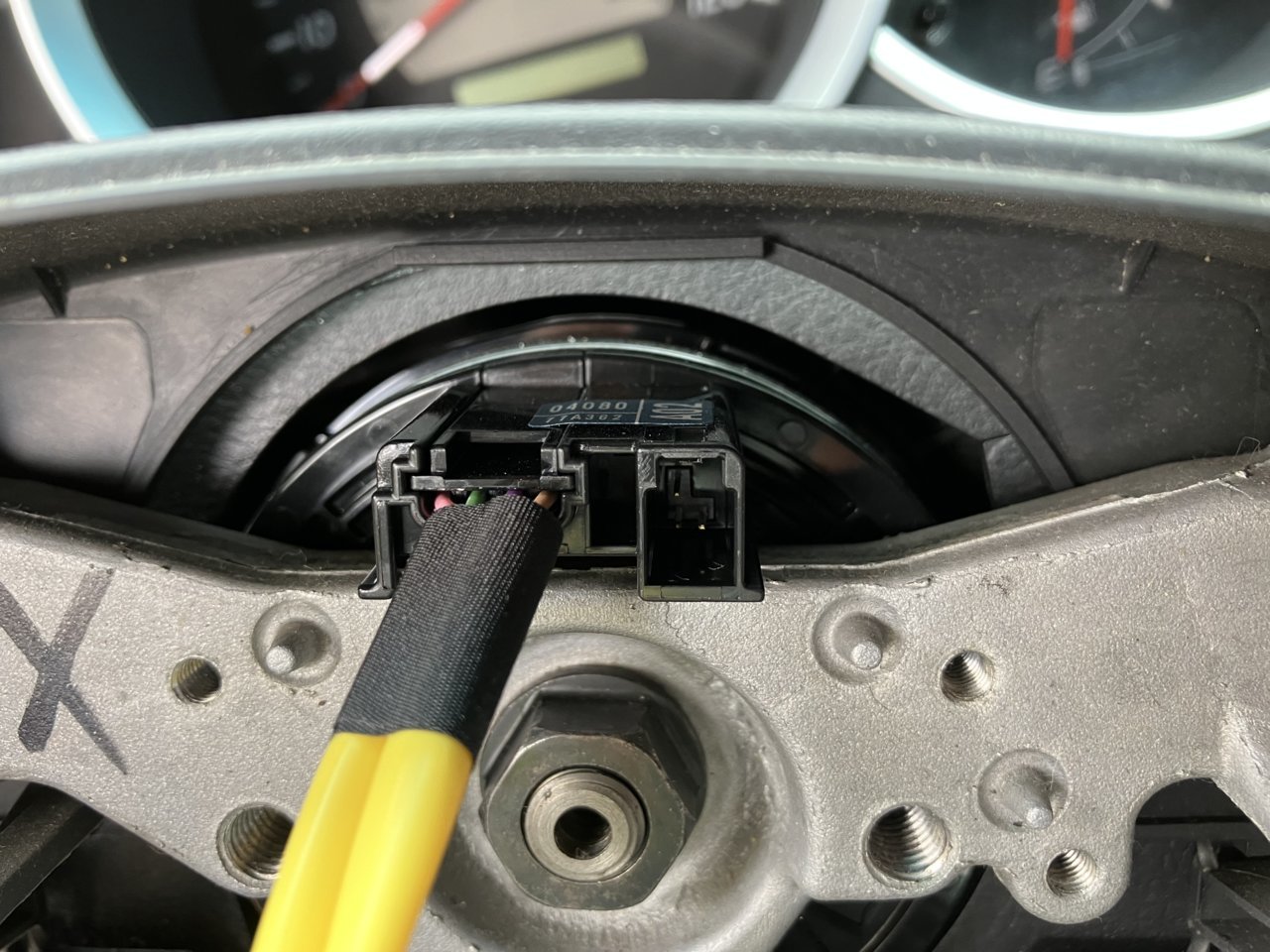

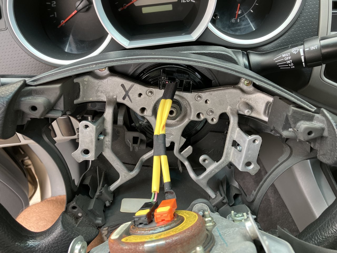

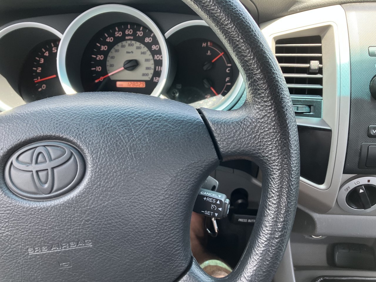

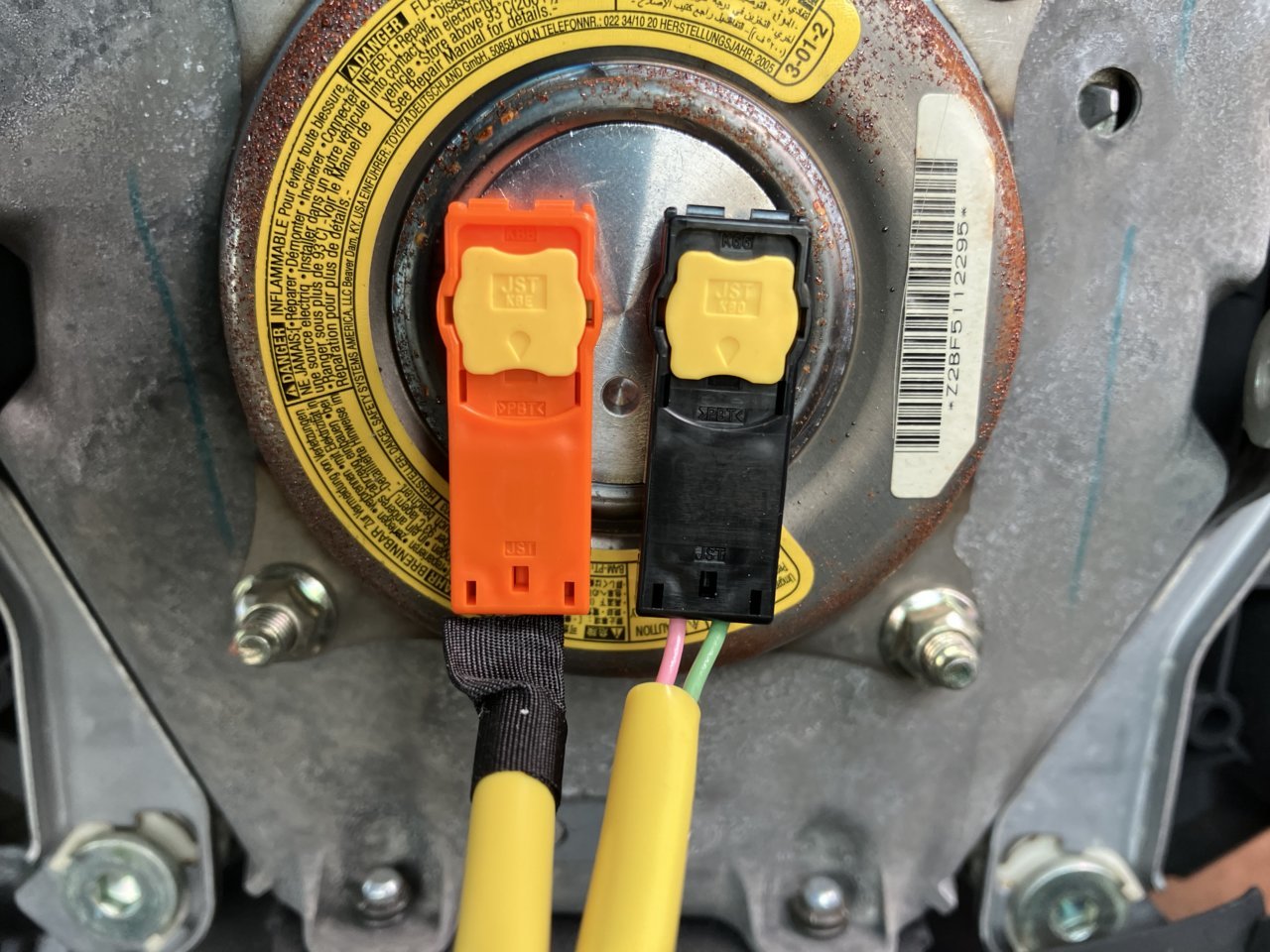

    Also photos of my wheel and bag. Didn’t attempt a wheel swap as I’m going to do half the drive today and the second half on Wednesday to help my bro in law finish his horse haul.

    Reg Cabs, 5 lug, 5 spd, Magnuson & LS Swap, StopTech’s, Yada Yada Yada…
    Where’s the photo of the cruise switch installed?
    i was thinking you could show the wire & switch so we could direct the next member here where the wire goes. How hard was the wire for the clutch pedal switch to locate?
