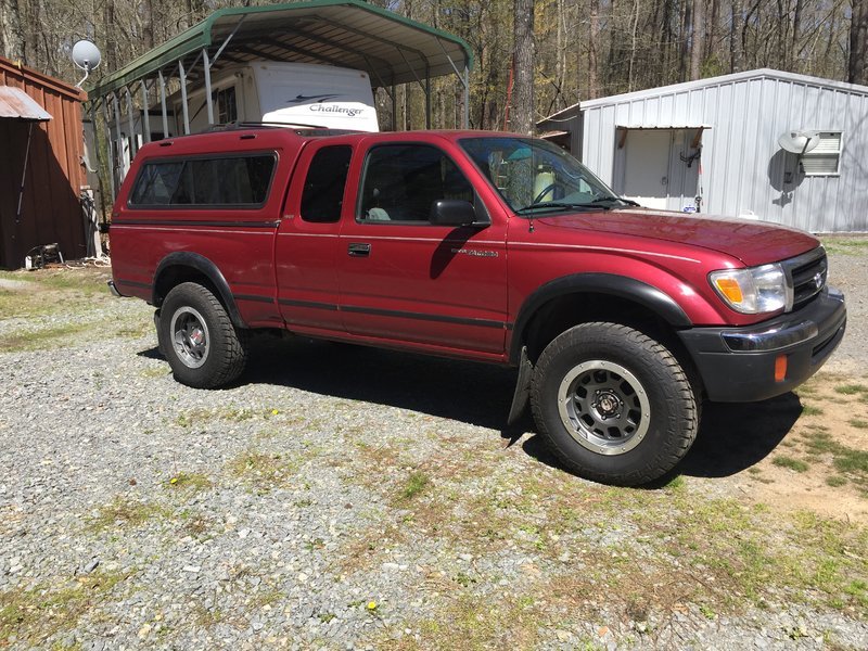

    I had 17" TRD Sport rims on mine for about a year. Started w/ no spacer and the tire was about 1/2" from the UCA. Added 1.5" spacers and they looked great! I've since gone to a 16" 4Runner wheel from an '02 limited and no spacers. I changed because I like the look of the 4Runner wheels over the 2nd gen TRD Sports.

    2,105
    2020 TRD Pro
    Do you have pictures?
    I'm curious how that looks

    Here you go or you can check my build
