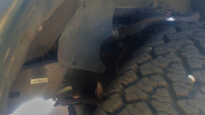

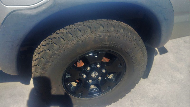

    Here is where the 265/75 r16 Duratracs rubbed.
    The aggressive side walls were most of the problem. Half inch spacers would fix the problem but they are illegal here and I would not go off road with them on anyway. These 265/70 16 Grabber AT2s will only rub hard left with some body roll.
