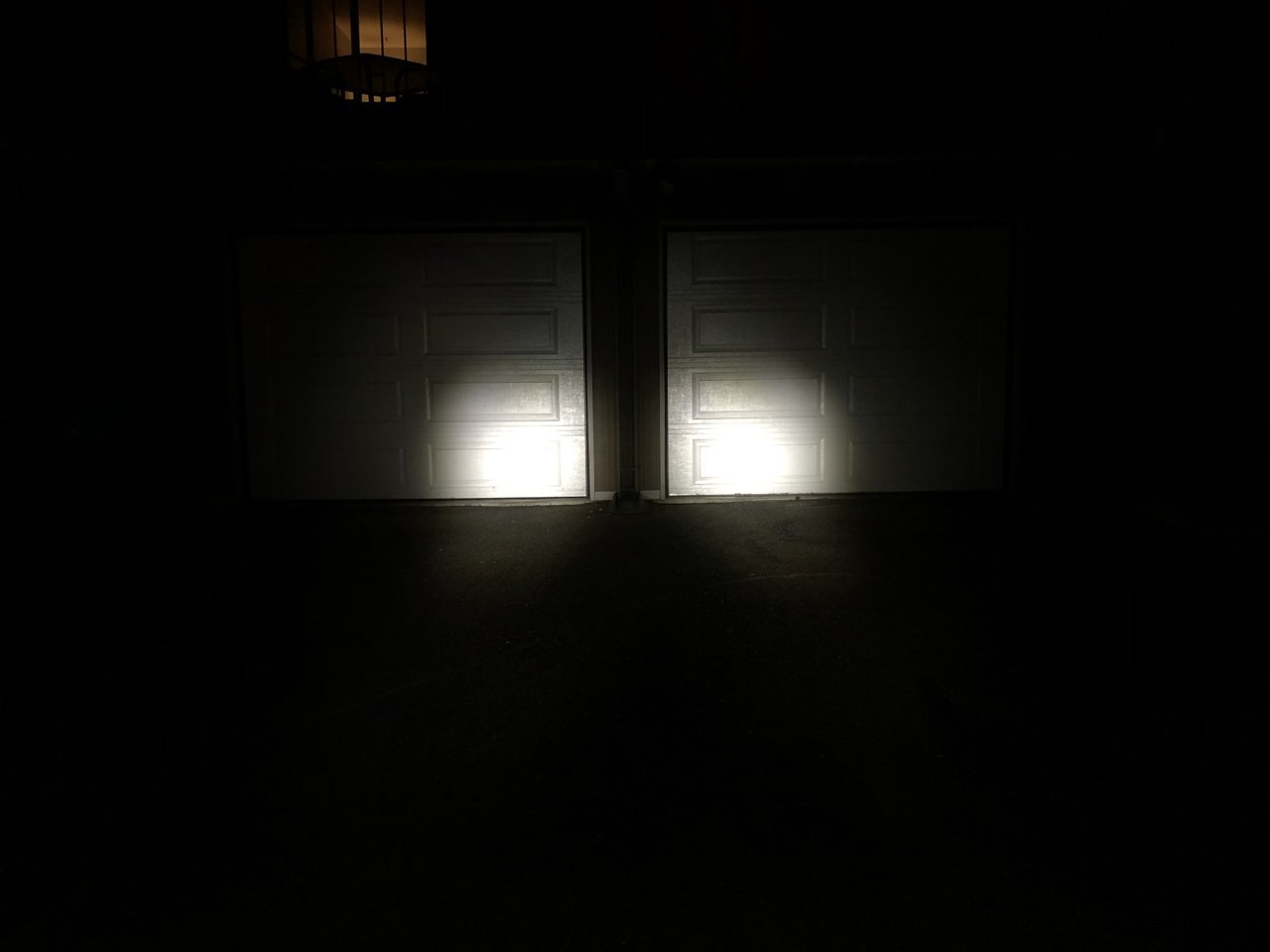

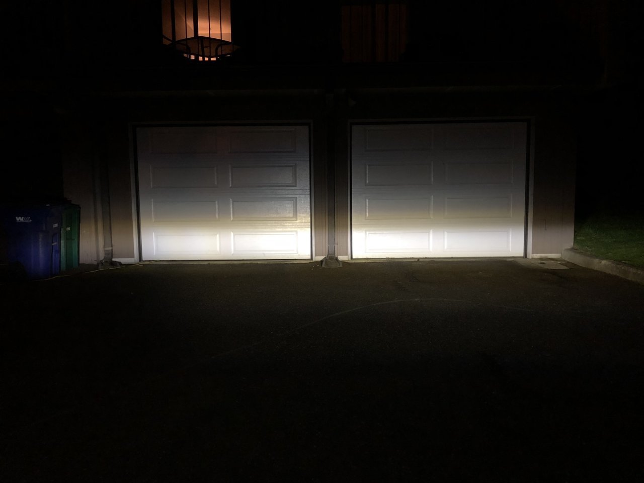

    Even at 18w x2 on each side you are still at lower power than stock bulbs, so no concern there. However the Cali pods are small spots, and very low output. If you switched your pods to real fogs you’d get what you are looking for out of a single light with a very wide pattern distribution that is far more useful.
    This is the Cali pattern (shown in white)
    This is a fog pattern
    Also note that spots like you have don’t have cut offs and should not be run with oncoming traffic. They are not a street legal pattern. If interested in amber (and not yellow) for early 2nd Gen I’d look at the amber Morimotos. Although you will get much higher performance out of selective yellow SS3s.
