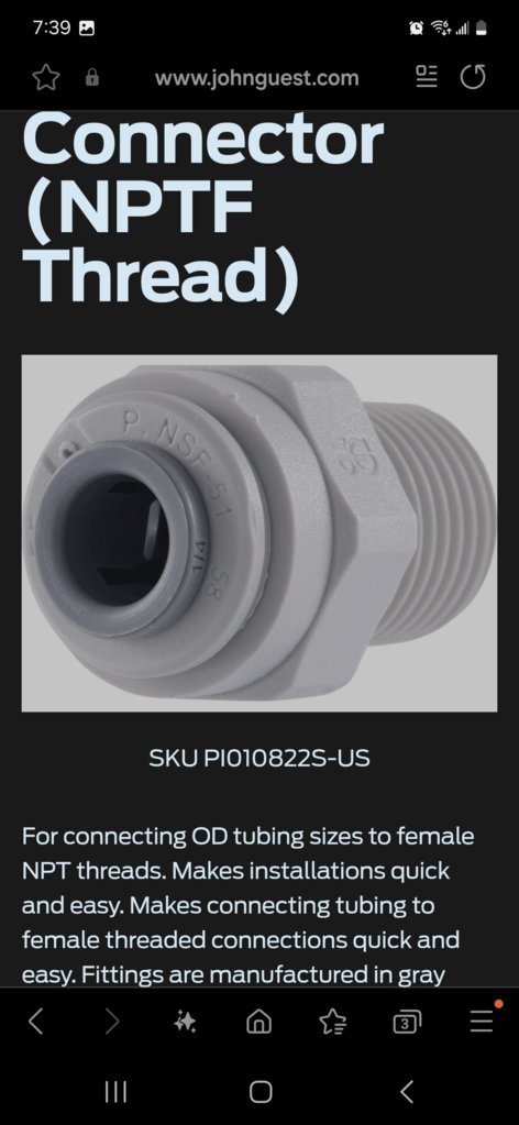

    I build automatic car washes with quite a few moving components and use this line/fittings to get air/chem mixtures out to the bay and we see very few failures. And like I said it's insanely easy to patch if you have 2 couplers and a small piece of tube on hand. With the variety of couplers you can get the routing however it works best for your application. I reccomend the food grade grey fittings over most as they seem to have the lowest failure rate compared to all the others I have worked with.
