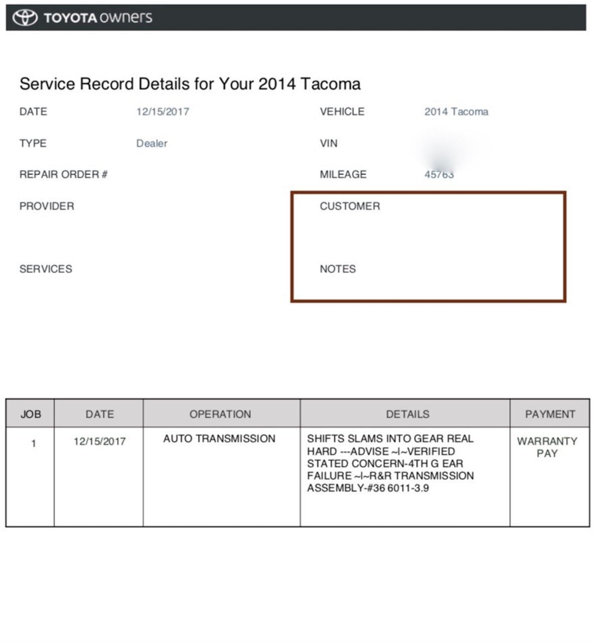

    The service report from the first transmission.

    Nothing online about the truck since its last service which was before the new year. and nothing about this second transmission issue.

    Doesn't really count for much.
    Where's the detailed write up that the dealer produces?

    Im not sure they even have ever done a detailed write up. They only ever just give me a copy of the invoice.
