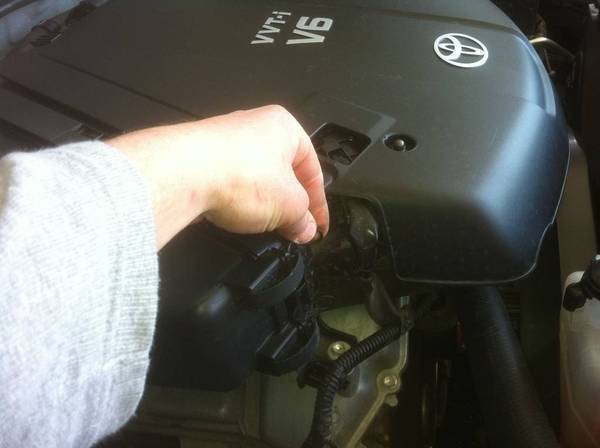

    Step 2: Un-clip air filter...

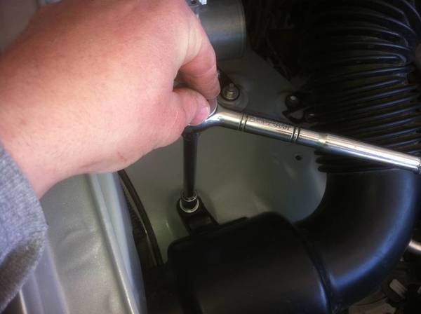

    Step 3: <Optional> Remove intake tube. This will make it easier to get your paws in there.
    There are two 12mm bolts which hold the intake on:

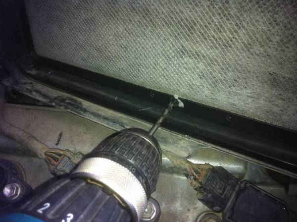

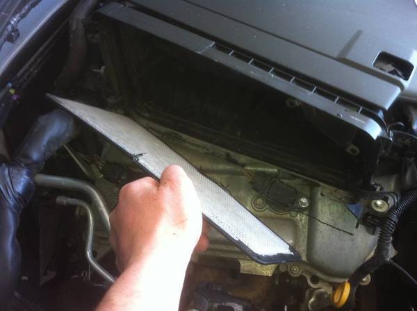

    Step 4: Using a small SHARP drill bit, drill out the 6 plastic rivets holding the secondary filter in place. A sharp bit will help in keeping you from sliding off of the rivet.

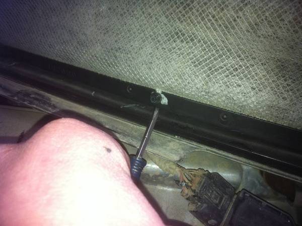

    Step 5: Remove Filter
    Try using a small flat blade screw driver to get behind the filter if needed:

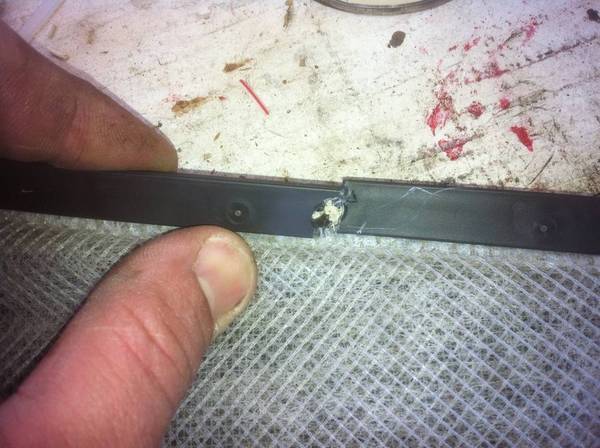

    And don't do what I did, and pry too hard...

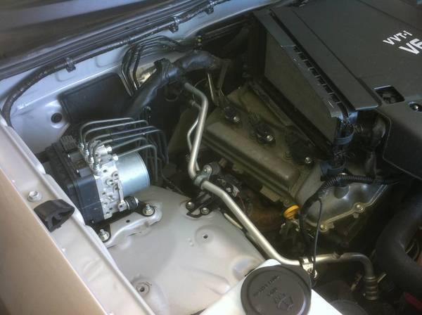

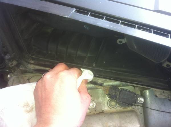

    Step 6: <Optional but recommended> Clean out that air box. Make sure any debris didn't get in there from opening it up. Also, it's not a bad thing to replace your air filter while you are there. If you can see light through your filter when backlit, it is good. Since I am purchasing an AFE drop in, I will do this later.
    Step 7: Re-install in reverse order hopefully..
