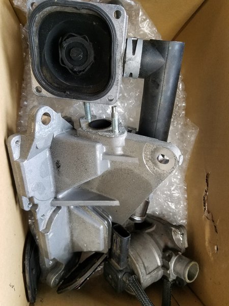

    Ok..Wasn't fun to get to the nuts on the rear exhaust connections or the bolts to the front connection but I got the job done and it appears to be fixed. Shame on Toyota for not at least providing this part under warranty.
    NCTacoma[OP] likes this.

    Good job. You didn't have to replace pump and vacuum switch, correct?

    Nope. Just the valve assembly. Thanks

    Is that your rear valve that we are looking at in the picture? That's exactly how mine looked and various others as well. I wonder if the rear valve is getting to much heat to it and thus deteriorating.

    The rear valve was only slightly worse than the front. The carbon buildup in both was unbelievable and both were actually stuck open. When I removed the pump and hoses there was lots of moisture so I think that's the major culprit leading to the failure.
