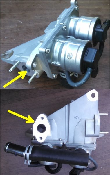

    I found the Diverter Valves at: http://toyotaparts.bochtoyotasouth.com/auto-parts/ Search: 2012>Toyota>Tacoma>(select your truck)>EMISSION SYSTEM>A.I.R. SYSTEM
    I received the Diverter Valves (Part Number 25710-31022) but the valves came pre-attached to a larger metal block which bolts on to the engine. On the engine, the metal block has two metal hoses connected which will be very difficult to remove. Attached are the images of the new valves. I am looking for any suggestions or recommendation on whether to install the entire new block with the valves, or just install the new valves. Thanks all

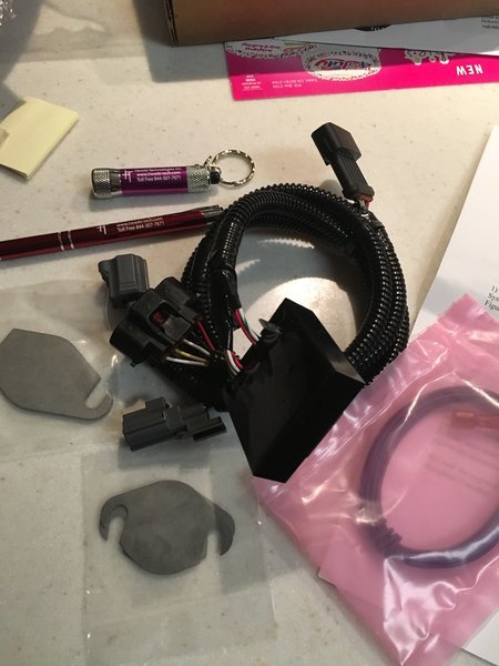

    Even get a sweet keychain flashlight and pen ;)

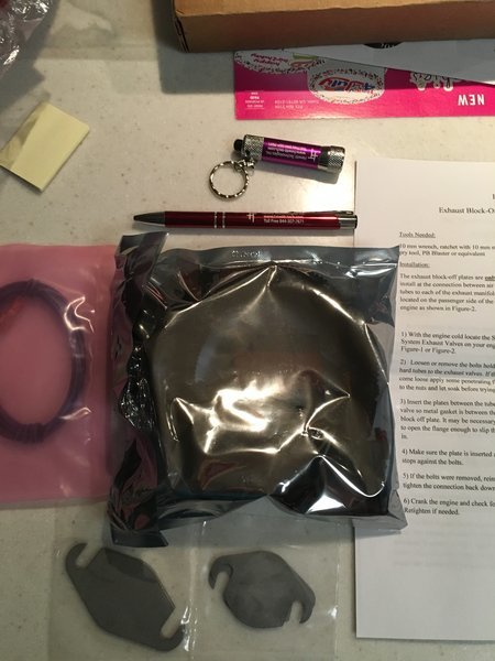

    NEED HELP guys, those of you that have installed the bypass kit:
    I have been at this install for over 3 hours mainly just fumbling with these block off plates, I can't seem to find any picture of how they look installed because they just don't seem to be sitting flush so everything goes back nice and tight (seems like there will be big time leaks) do any of you guys have any pics of how these plates look installed? I really need to get this done so I can drive. Also do the stock bolts seem rather short? It seems like the top 2 on the valves (after a plate is behind it) aren't long enough to "catch" and when they do I tighten them just a bit and they strip every time. Any help asap would be great. The instructions that came with the kit just aren't cutting it for me as far as this plate install I need to see real pics.
    Thanks!

    I got it! Just must have been the heat I was thinking stupid and thought the plates went behind the actual valves lmao! After I went inside frustrated and cooled off in the AC and looked at the diagram pics again I clearly see that I was being stupid....fail
