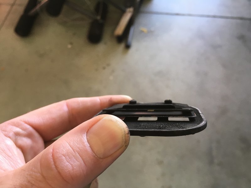

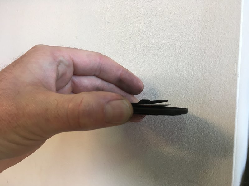

    2012 TRD Sport with 37,000 miles. Threw the P2442 code, and was able to clear it, and tear apart the valves. Number 2 gasket was totally melted and just fell out when I took it apart., and both were black with about 1/8" of soot. The check valves were warped open, and pretty much destroyed. I attached pics of the valves and solenoids.
    Living in the OBX of NC, the closest dealer to me is about 100 miles, but they were really cool and the tech was aware of the problem. Sadly he had already tried to get this same issue fixed under warranty on his friends Taco, and was denied. He was able to test the system, and the pump checked ok, as did the valves, but he said it will come back. I was quoted $650 for the Valve assy. P/N/ 25710-31022, and $240 for labor. The tech recommended I just do the Hewett-Tech Bypass kit for half that.
    The truck was fine for a week, and last night it popped the code again. I just ordered the Bypass kit from Hewett and should have it in a few days.
    Thanks to everyone for the info on here; I'm sad to see so many of us have this known problem. I have already filed a complaint with the NTHSA (was the 92nd complaint, Number 10937233), and opened a case with Toyota Corp. (The Customer service person said I was her 2nd call in less than a week for this issue. Case #: 1612300783). I was told to ask about a "Goodwill Warranty" at the dealer. The most they could probably do is 50% off the bill, which is still more than the Bypass Kit, so I'm going that route for now.
    Here's to hoping this gets addressed soon. Keep those complaints rolling in, it's the only way Toyota will be made to fix this.
    Also, From talking to Hewett-Tech, the 13's and up are starting to see this problem too.....
