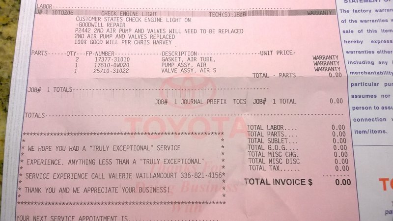

    I'm a new member to the P2442 code club as of yesterday. Left the gym and the truck had no power, looked down and the check engine light was on as well as the traction control light. Ran by Autozone and had them scan the OBD and there it was...... the dreaded P2442 code. I took it by the dealer this morning and sure enough they say both valves are gone as well as the air pump. Estimate was $1,798. This is a 2012 model as seems to be the norm with this failure. But with only 35K miles. I told them this was ridiculous for this to happen on this model with this low of a mileage. The service rep said her hands were tied. I talked to the Service manager as well as the GM. Toyota Care was closed due to the holiday. I was sure to mention how I had purchased 10+ new Toyota's in my life as well as 2 new Lexus's. And that many of them had come from this dealership and that they currently do all my maintenance work even on my wife 2015 Lexus RC350. They told me to call Toyota Care tomorrow and plead my case and they would see what they could do.

    I heard back from the service manager at about 6:00 pm this evening. Said he was able to get in touch with his district Toyota rep. earlier today. He said not to worry everything would be replaced at no charge. No parts no labor. He would get the parts on order and that they would be in touch with me before weeks end to set up a time to bring the truck in. He didn't say under what warranty it would be covered. Just that it would be covered at no charge.

    Got my valves and Air pump replaced yesterday. Thank goodness the parts finally came in. I was getting tired of unhooking the battery every morning to clear the Limp mode out. And my many thanks to my local Toyota dealership for getting this $1800 repair done under a Goodwill warranty.
