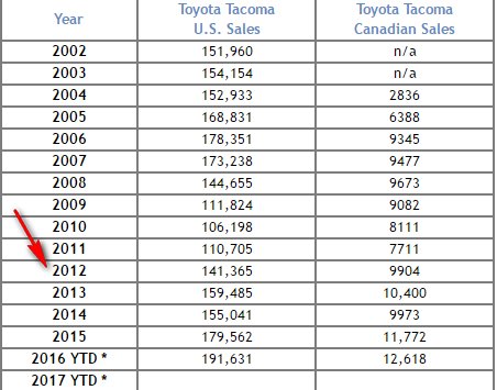

    I'm not so sure that will keep happening over and over again. Toyota sold over 150,000 Tacoma's in 2012. It did happen to me and it has happened to some of you. But I'm wondering what % of 2012's it is actually happening too? If it is the plague as we are thinking to the 2012's then there would be Thousands of theses failures. And I'm seeing less than 100. But I'm sure many go unreported on TW. The Service Manager at my dealership said he had seen many Tundra's with this problem and mine was his 1st Tacoma.
    Not taking Toyota's side as my 2012 DCSB caught P2442 infection. Just stating the numbers and facts as I currently see them.

    Also keep in mind the Tundra was affected from 2007 through at least 2012 with about 120k units sold per year. So that's 720k Tundras with the same crap setup - five times as many as 2012 Tacomas - and they are up to 10 years old instead of just 5 years old. So really not surprising that a dealership would see a lot of Tundras with the problem before seeing their first Tacoma with the problem.
