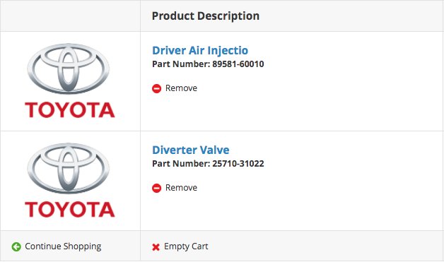

    Does anyone know how the Driver Air Injection looks like?
