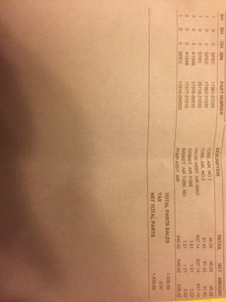

    Dealership looked at it today said they can't duplicate, told them to keep it another day to see if it fouls again! I had a parts list with pricing pulled up to start shopping around! I'll attach a pic of the list! I'm looking for advice on better or comparable prices and want to make sure that they are the correct parts!

    It was still in limp mode, yesterday was day 2 at the shop and they still couldn't duplicate! I have her back now and drove about 15 miles since, still nothing gonna take it out and look at it this week! They obviously cleared the code on Monday, spent 2 days trying to duplicate then threw a $1990 parts and labor quote at me then charged me $120 for diagnosis based off what I told them not what they could find is what the service manager said! Not too happy with these guys!

    Are you still under powertrain warranty? I was when mine failed and the only thing I could get Toyota to waive is the diagnostic fee they tried to charge me. If you want dealer to fix it just have them remove the rear most valve and you will see the deteriorated rubber around the valve.
