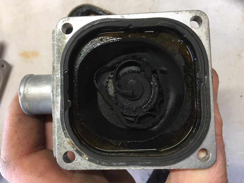

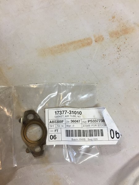

    It took about 8 days to get the part (25710-31022 air switch valve assembly) from toyotapartsestore.com but saved about $150.00 compared to the dealership part cost! I ended up spending another $3.00 on a couple (17377-31010 air tube gaskets) which I recommend buying before you go to switch the part out yourself as I bent one in the removal! Brand new to DIY mechanics but this took me and a buddy about 2.5-3 hours total. I took a lot of pictures that I'll post and briefly describe to hopefully help someone else out. Thanks to everyone who has been posting on here before me!
