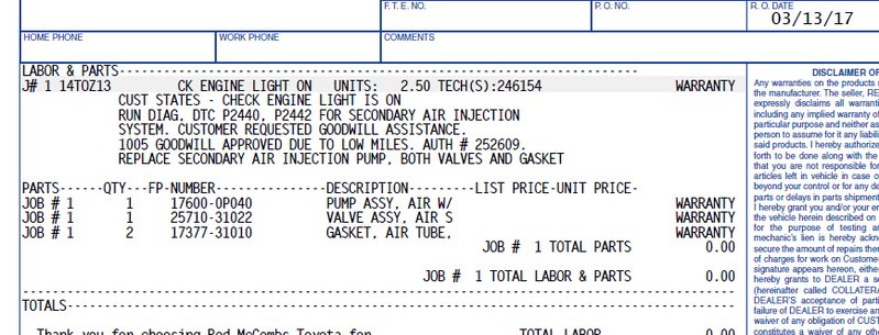

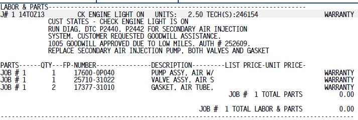

    So i joined the dreaded Secondary Air Injection Switching Valve Open club on Saturday. But it had a good outcome..so here is my situation/advice.
    - It happened on my 2012 at 38K miles. ....and went into Limp Mode on Saturday night. I had the codes read for free at Autozone which showed P2442.
    - I spent the weekend bookmarking and printing every instance of either Dealership Goodwill warranty or Toyota approving it fixed under warranty. also printed up the TSB on the Tundra.
    - I normally keep my truck clean, but I made it look brand new inside and out, before I took it in. I wanted to show it is well taken care of. This is the first time my Tacoma has ever been in the shop (for other than normal service).
    - I know a lot about working on cars, but I went in calm, polite and played a little dumb.
    - Took it to the dealership I bought it at and had all normal service done
    - I said the following "I got the check engine/traction lights and it won't go over 30mph. I will be honest with you, I had the codes read and it showed Secondary"...at that point the service manager interrupted me and finished the sentence....he said we get that all the time and asked if I had an extended warrany (which the answer was No) I then said..I understand this is going to be expensive...he said "Yes it it is". I replied, "I understand this exact same part/problem is covered under a special extended warranty for a Tundra, but not the Tacoma." He said that is correct.
    - I then ask "I am hoping you can work with me on this? Can you or the Service Director authorize a Good Will Warranty or should I call Toyota during the day?" He said "lets confirm the problem and I will call you before we start any work."
    - 2 Hours later he called "We are going to take care of this for you. I already spoke with Toyota and it will be fixed free of charged (both the diverter and pump)" (I never had to break out my file of evidence of previous warranty grants)
    - I asked about it happening again and if I should invest in a bypass. He said...they used "Newer version" of the parts...the sponge will not be sucked in....he said it is happening so often on the 2012+ Tacoma's he had no doubt it will be added to the Tundra TSB. He said if it happens again, they would cover it again.
    - It appears low miles helped my situation. It has 38K on it and will be 5 years old in June.
    - That is my story, thank you to everyone who provided evidence and advice..and good luck to all.

  13. Mar 14, 2017 at 5:14 PM
    #653
    Alloutdrs1
    Alloutdrs1 Well-Known Member
    Feb 28, 2012
    #73780
    1,164
    Andrew
    Virginia Beach, VA
    12' Mag gray Doublecab 4x4
    Distinct Offroad light bar, Rigid E-series and amber duallys, Leer 100xq, Oem roof rack, Oem bed mat, Bullculla trailer plug relocate bracket, Rear diff vent mod, front mud flap chop, Color matched Grille w/Andres devil horns, Wet okoles and weathertechs
    Nice! Glad to see it worked out for you, a good dealer is no doubt a key in getting this handled. Also like to hear him talking about it being added to the Tundra TSB. I had to use goodwill warranty at my dealer to get them to cover the tsb for engine pinging so when this came around not much help from them again. But I can replace these parts and not able to reprogram the truck ecm so I guess take it for what it is.
    So he confirmed that the new parts are a new design? I'm going to have to compare your part#'s to what I replaced mine with. Thanks for the info.
