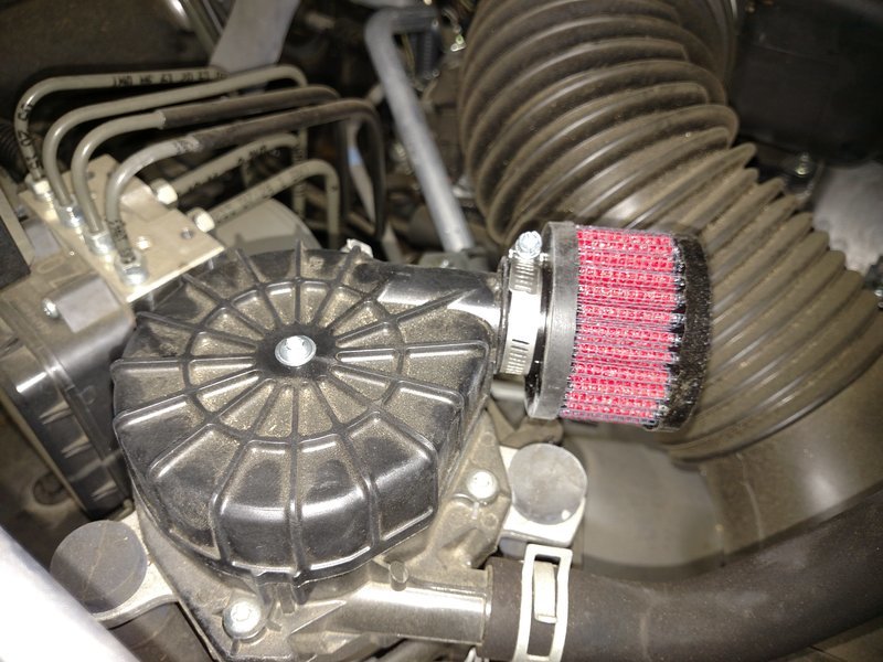

    I suppose it could help reduce the chances of water intrusion from above through the fastener locations (and associated corrosion) that could be caused either by splashing (would have to be drving pretty damn hard for it to get all the way up there), condensation, or even engine bay washing. Also, the originial "mushroom tip" intake cap is simply open around its circumference toward the rear. The "new" housing cover (standard on my 2015) whould help reduce incidental splashing intrusion into the mushroom tip (yes, I am going to say "mushroom tip" as much as possible). I think the latter issue is probabaly what they really wanted to adress with the cover.
    This pic after I removed the internal OEM filter and installed the new Uni filter to replace the hollow mushroom tip (there it is again) shows the exposed fastener heads. I did put the cover back on mine (no pic handy), and the Uni filter fits under the new cap perfectly, too, while still offering plently of breathable, but completely protected, intake surface.
