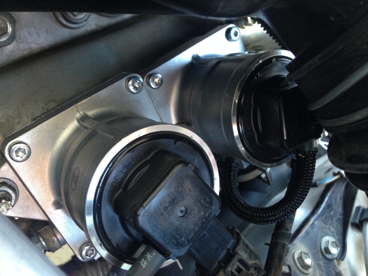

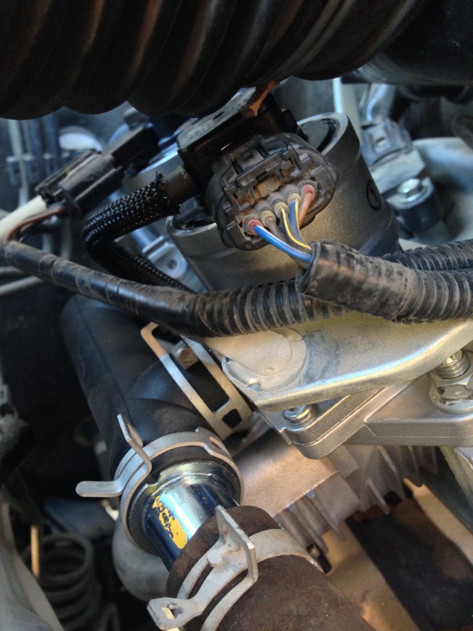

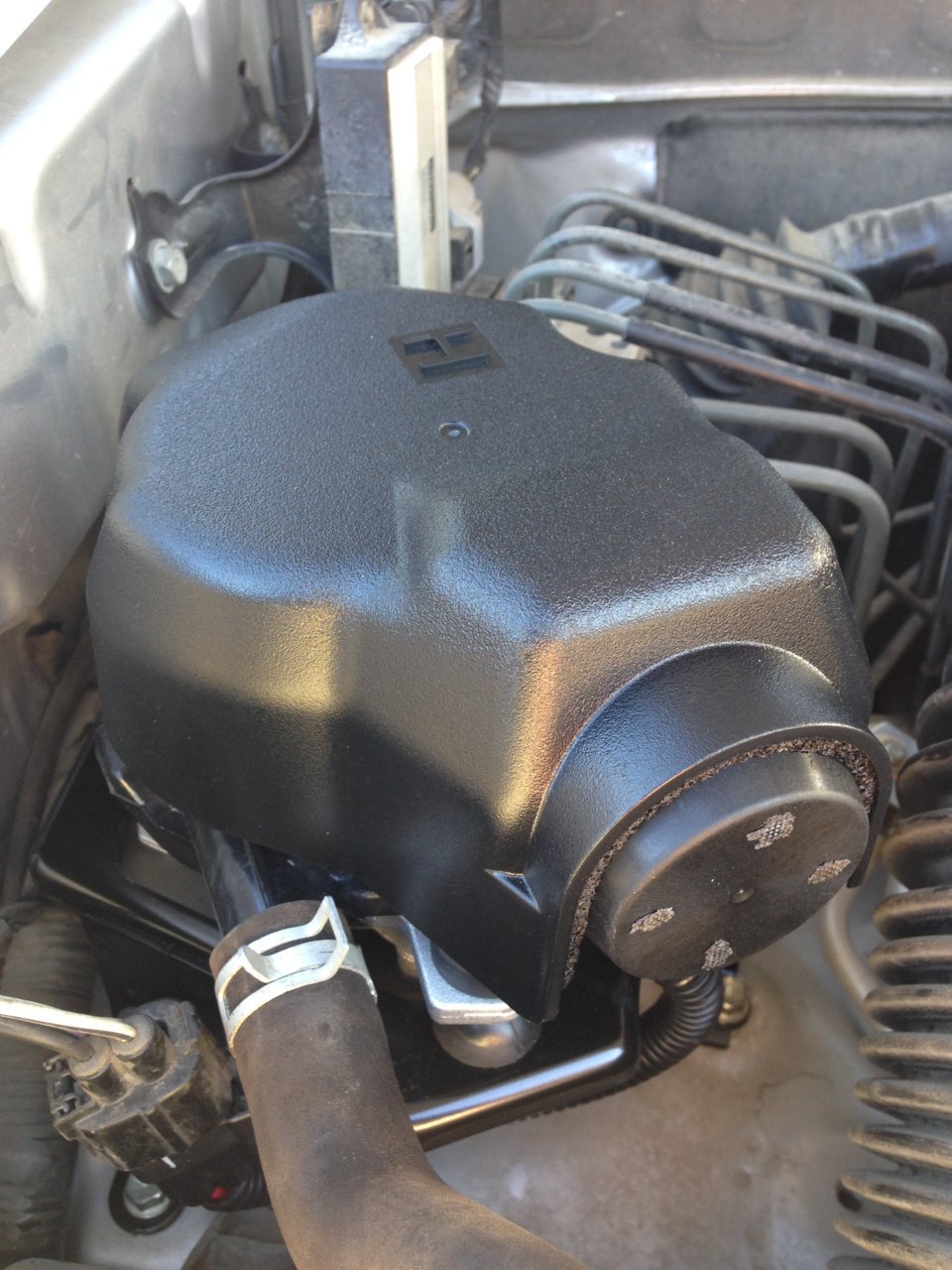

    Adding myself to the list. 2012 and just happened last week (CEL/Trac Off | Code P2443). I was at around 62,700 miles. Luckily this thread helped me know what I was dealing with, and had no issues whatsoever at the dealer. Fixed right up and on my way. Bummed that I had to deal in the first place, and to hear that it may not be the last of it. Still love my truck though.
    20180603_000323987_iOS.jpg 20180603_000342761_iOS.jpg 20180603_000431621_iOS.jpg
