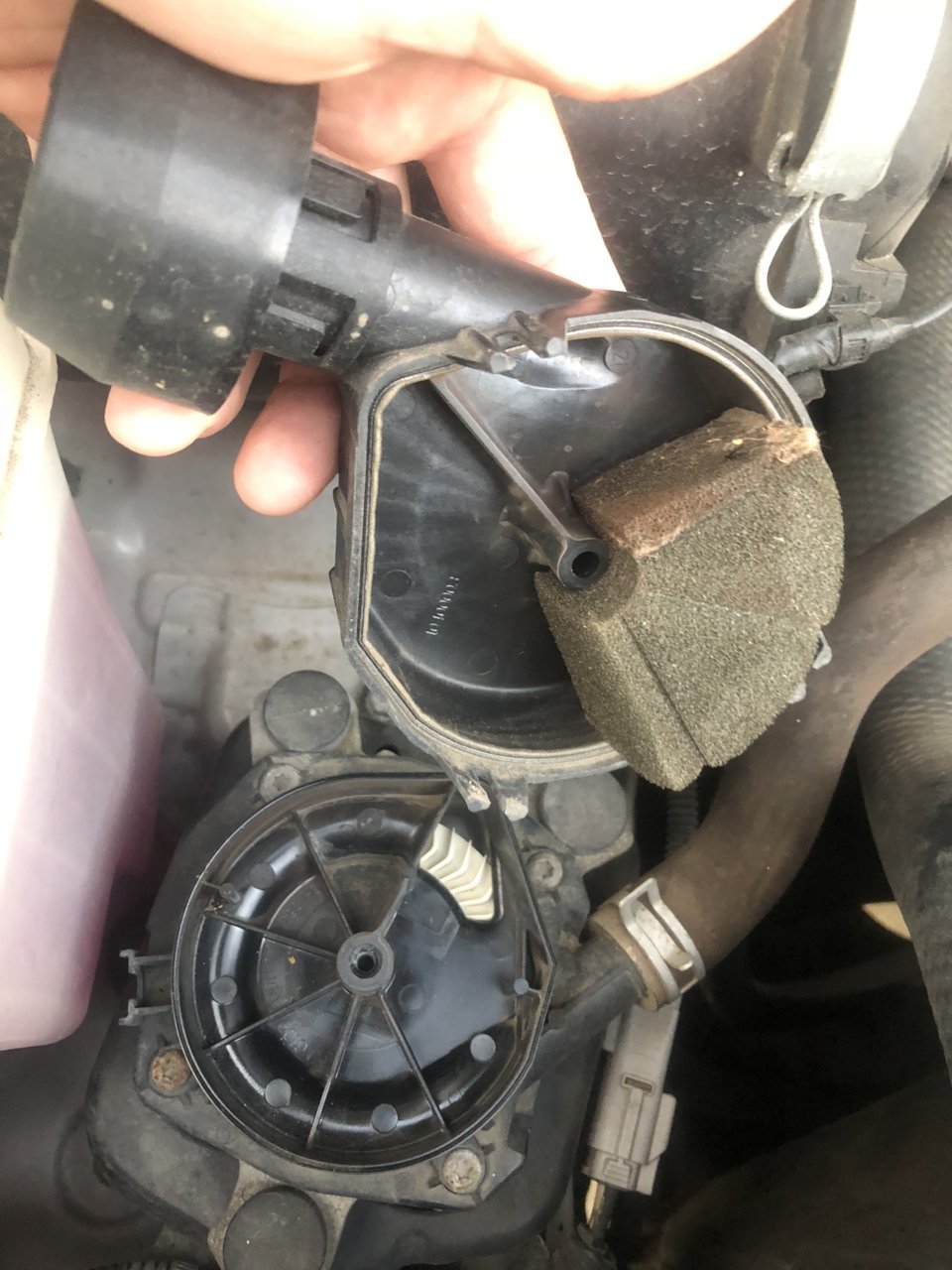

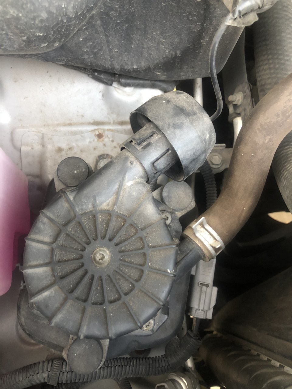

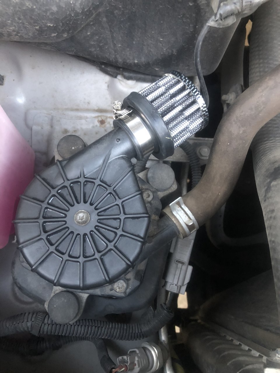

    9E03F597-806C-4755-AA23-A35EAE2C0B6C.jpg BEBA9041-79EE-41D3-84D6-36232235CFDB.jpg 6C66AFDB-9C2B-4E7D-A458-A1CA4A8FE9CB.jpg Done. My 2008 has just over 106,000 miles. Pictures are before, during, and after the swap. Notice the discoloration/degradation of the OEM filter. I am glad it had not caused me any problems yet.
