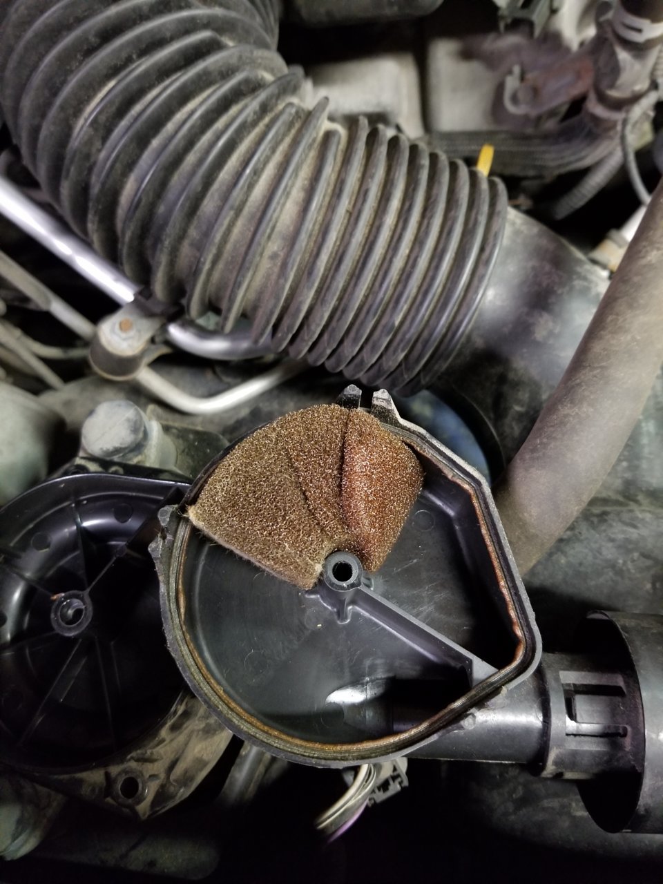

    Just did this mod, one less thing to worry about.

    Just flipped a p0418 for a relay. I have done the United filter mod and the foam was in great condition. It still runs on startup and shut down so I don’t know if it’s the valves or not. Took the hose off and blew into it and had a lot of pressure so I’m guessing they are closed. It is bank 1 so maybe that is staying closed the whole time. Thankfully my dad works for a dealership so won’t cost me arm and a leg but will update Saturday afternoon because not many threads on 0418 code.
