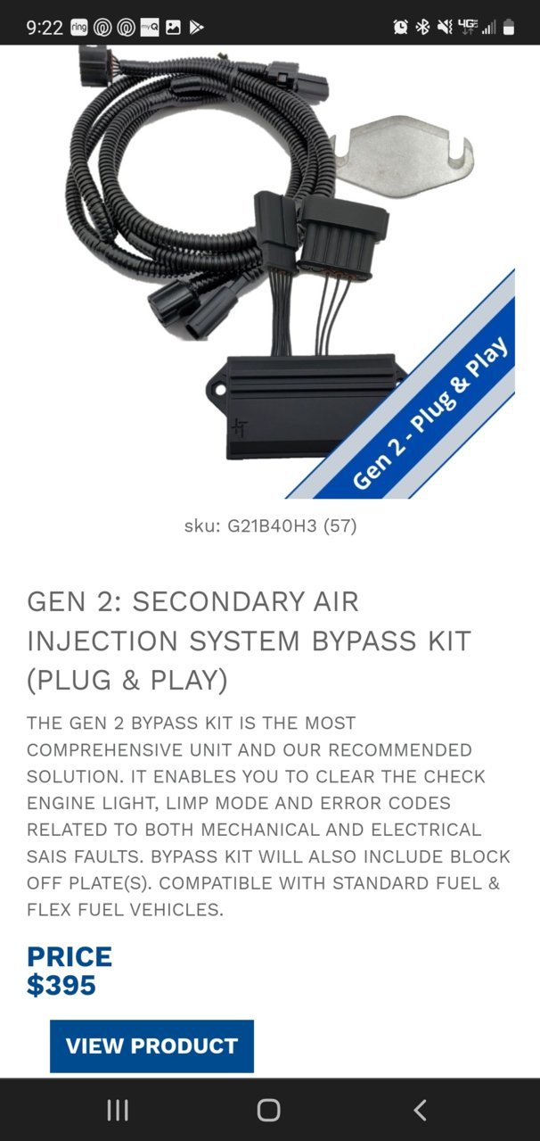

    Driving to work today I my dash lit up with check engine light and trac off... pulled the p2443 code....
    Looks like it's my turn to read this entire thread...
    Just curious...this is a plug n play and will make the ecu think all is well... i still am required to take emissions, basically they plug into obd-ii, no inpsection...throwing around the idea of just going this route....
