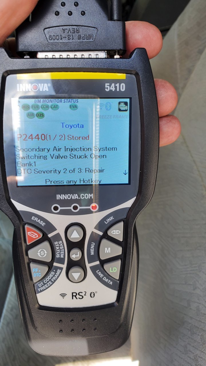

    2008 Taco owner. I the this p2440 code today. Auto Zone said some carb cleaner would cure it by getting rid of carbon buildup keeping the valve open, but that sounds like bogus advice based on this thread.
    Looking for advice. Can't do my own repair. Displaced from house after a fire so no tool access, and I break em worse before I fix it right.
  11. Jul 5, 2023 at 5:01 PM
    #1131
    Slashaar
    Slashaar Trail Limo Supreme & Certified Hole Massager
    Nov 23, 2017
    #236717
    15,538
    Josh
    Kansas City, MO
    2015 Tacoma TRD-Sport DC LB
    Coastal HC Front, 6112s+650lb King Coils, JD 62 Swap + 14" Fox 2.0s
    They aren't hard to pull apart, then you could see about cleaning them. I deleted mine for the most part, but if I did it again, I'd VFTuner it completely out of the ECU and junk the whole system.

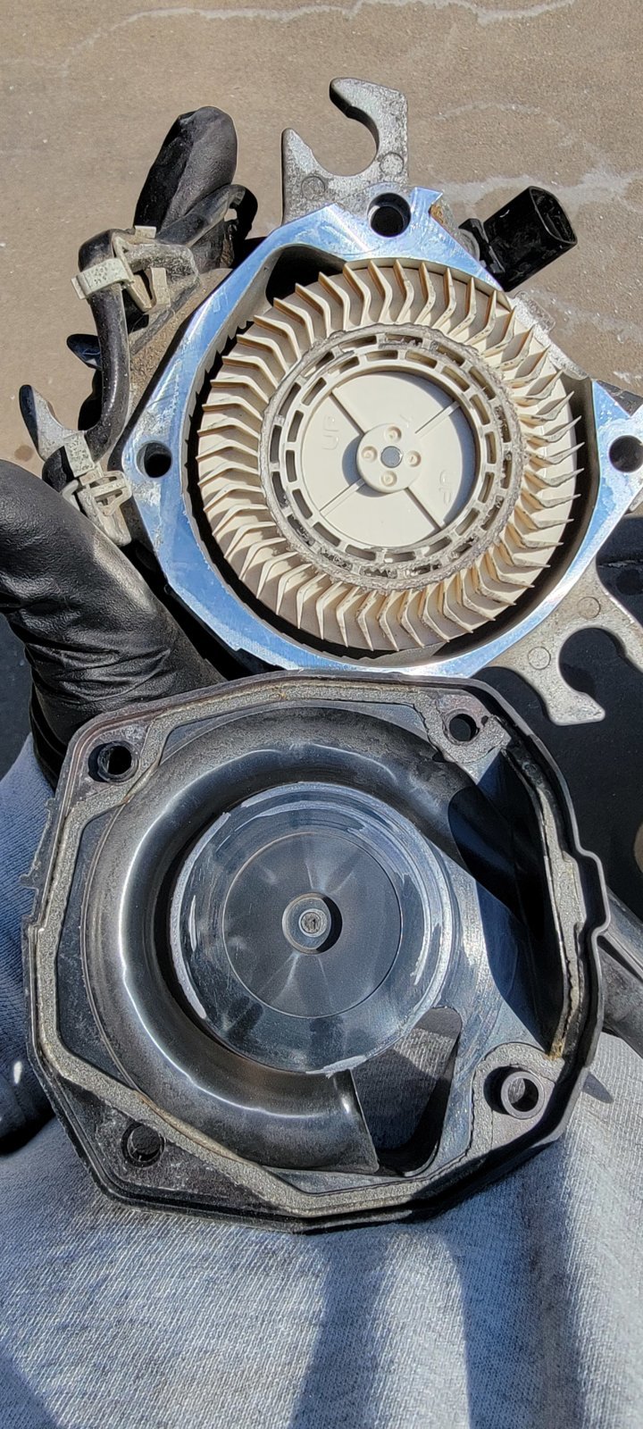

    20240329_140724.jpgI pulled the pump out and apart this afternoon. Spinning the fan with my finger I could feel it sticking in one spot. I popped it apart and sanded the inside of the lid and the top of the fan where they were clearly rubbing. I put it all back in and cleared the code. No issues for the rest of the day.

    2014 DC OR 6spd 4x4
    Predator tube steps, Ranch Hand grill guard, Magnaflow CatBack exhaust, Toyota tool box & bed mat, 2LO Module by @Up2NoGood, Rearview Compass/Temp Mirror, Tune by @JustDSM.
    2012s got an extended warranty on the SAIS, it wasn't a recall.
    The system was updated in 13 to do a purge at shutdown which decreased the number of problems the system had thus no extended warranty on 13+ models.
    Did you check the foam filter? That is the cause of alot of the SAIS issues because it deteriorates and gets sucked into the valves.

    It hasn't had the foam filter since the first week I brought it home new. I put the Uni filter on immediately.
    I'll keep an eye on it and probably go with the Hewitt kit if it throws a code again.

    Thanks for posting that pic of the guts. What a dumb piece of crap. I put the Uni on my 2015 several years ago, but my truck is pretty low mileage, keep fingers crossed. Especially if I'm aired down 50 miles from pavement...that is 100 miles from a fix...:rolleyes:
