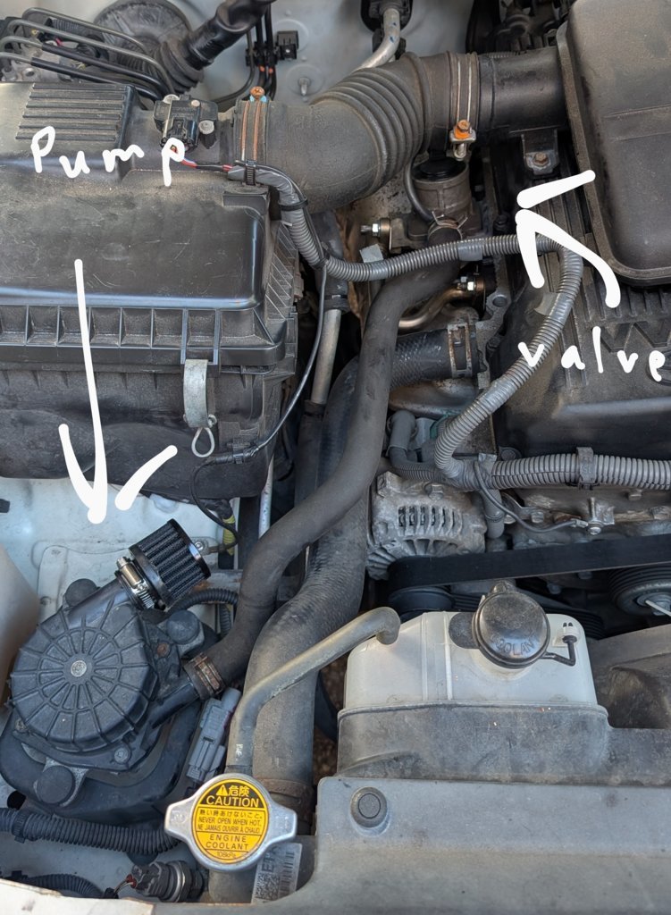

    Figure I'd drop a link here to my most recent thread: https://www.tacomaworld.com/threads/p2440-the-cheap-way.846885/
    Since my valve wasn't fully cooked I was able to clean it up and it's back in service with a new little air filter on the pump
    The job can be done for almost nothin', or if your valve is trash, junk yards near me sell them for $70-$120. Unsure as to whether valves from tundras and forerunners are cross-compatible, but I'm inclined to think so. If I had to go that route, I'd pop mine off and take it with me to the yard.
