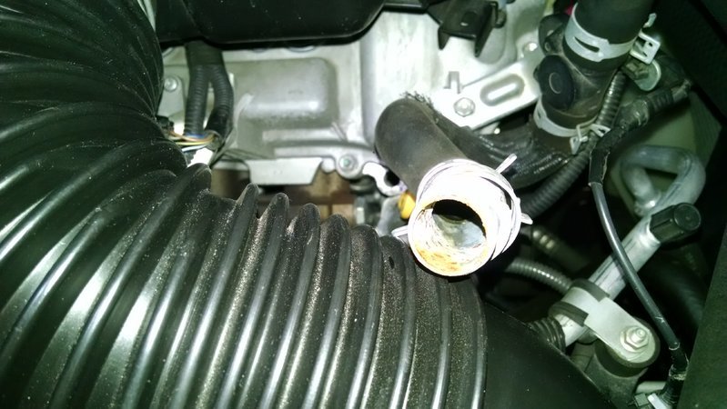

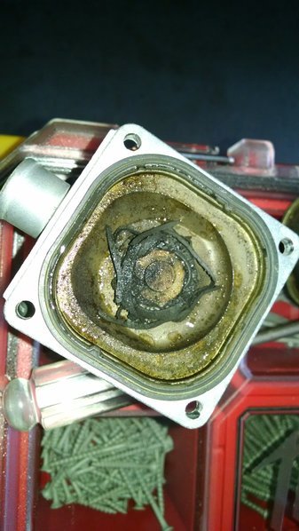

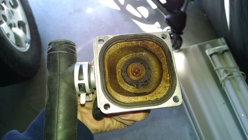

    Well no dice on my end, dealer today said they wouldn't cover it. I call back Toyota corporate who puts me in touch with regional manager and him and service manager decline coverage. Acknowledge that I had it in there at 29k for the issue but couldn't be of service now.
    So I limp my truck home and take the stupid pump apart, it's good. Take valves off and they are full of moisture, rust and the rubber around the valves is in terrible shape. Poor design imo and destined to fail on all Tacoma's with this system. Here are some pics of what it looked like. The front most valve wasnt to bad but I'd starting to show signs of the rubber coming apart. Where are you guys sourcing these? Looks to be a Toyota only part.

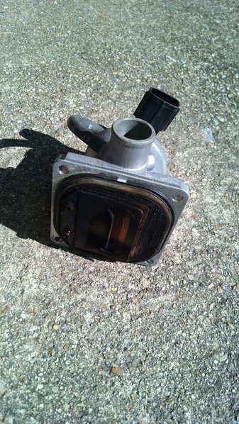

    I ended up replacing the valve today, Part# 25710-31022 at a cost of $470.00 and that was at Priority Toyota who was the only dealer with one in stock. My dealer Charles Barker who I took the truck to for warranty work wanted $1,396.79 for the repair. Replacement was very straight forward and only took me about 40min.

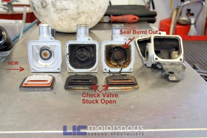

    I did take my pump apart and check the filter, it was intact so my problem was the design flaw of the valves. I think I am going to eliminate the foam filter though as it can only lead to trouble down the road. I came across this thread where lexus guys are removing the filter and placing a breather filter on the end of the pump housing instead.
    http://www.clublexus.com/forums/gx-...tion-system-fault-solution-with-pictures.html
