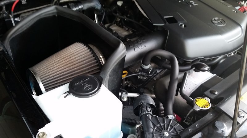

    If I may ask. Why are you going from K&N back to stock? Emissions tests??

    I just like the OEM setup better. I feel it provides better filtration.
    I can't think of any advantage of the K&N. I wish I could, Im not looking foward to the work.

    I understand. I believe I would check the filtering capabilities of the OEM and the K&N (micron rating). Before I changed anything.
    Feeling something is better doesn't necessarily mean it is better.
    As they say. Men lie...Women lie....But numbers don't lie..... Not if they're accurate anyways. :D

    The numbers are out there, the K&N is complete trash when it comes to filtering. Worse than every other option by a mile. Shockingly awful actually as I recall. I'm mobile at the moment but should be easy for a search to find the relevant thread and test.
    EDIT: I should add that the K&N does have some of the best flow ratings which is what they mean by "performance" in their marketing - it provides the least resistance to flow but it also filters the worst. Blackstone Labs can actually tell if you are running a K&N from a used oil analysis because vehicles with the K&N have a much higher silicon content than those using OEM or equivalent.

    Thank you. Not to mention, it's sucking warmer air than stock. I'm tearin this junk
    out now!

    Alright, off mobile so I could find a few tests. The most often sourced "visual" test is over on BITOG where a second filter was added after the filter under test and the color of that second filter an indication of how much contaminant was being passed. The K&N filter is quite dark compared to the others.
    But numbers was the real question and for that this test is probably the best source:
    http://www.gmtruckcentral.com/articles/air-filter-study.html
    And for those who don't like clicking links and want the TL;DR:
    And for the search engines or if the image dies a decade from now the results are the K&N passing 35% of contaminants while the OEM equivalent are all passing less than 5%.
