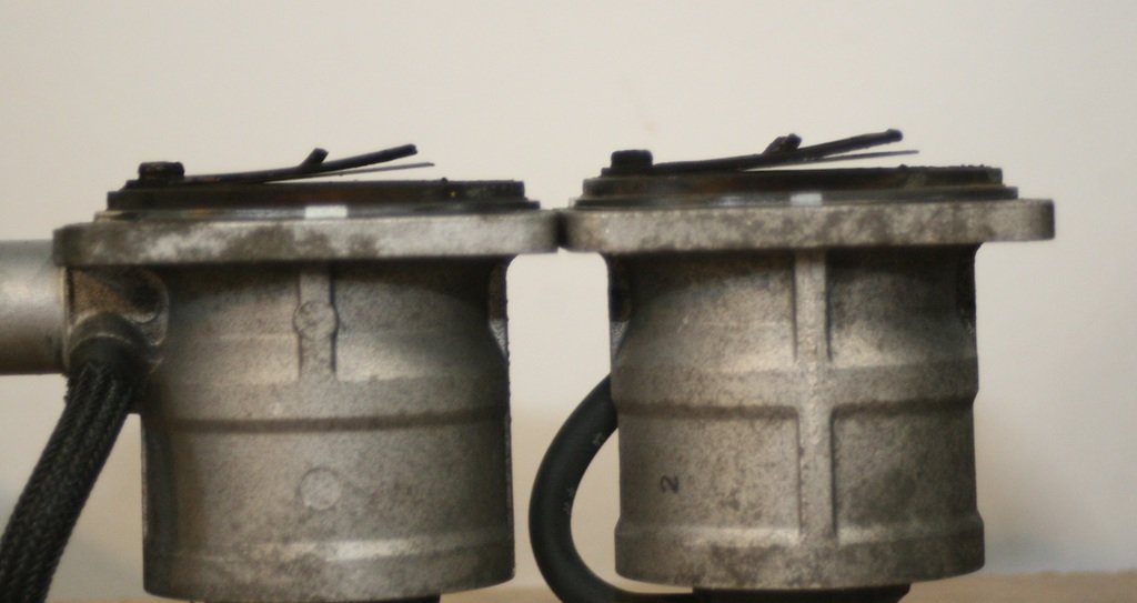

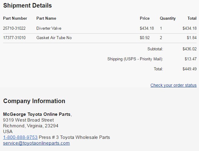

    Here is what I ordered from https://www.toyotaonlineparts.com/
    Got my parts uninstalled this morning, hopefully have the new part arrives this afternoon and I can get my Taco back on the road. Taking lots of pics and I am still planning to post a DIY thread.
    Here is the inside of the valve housing, and the two "stuck open" valves, which clearly are.

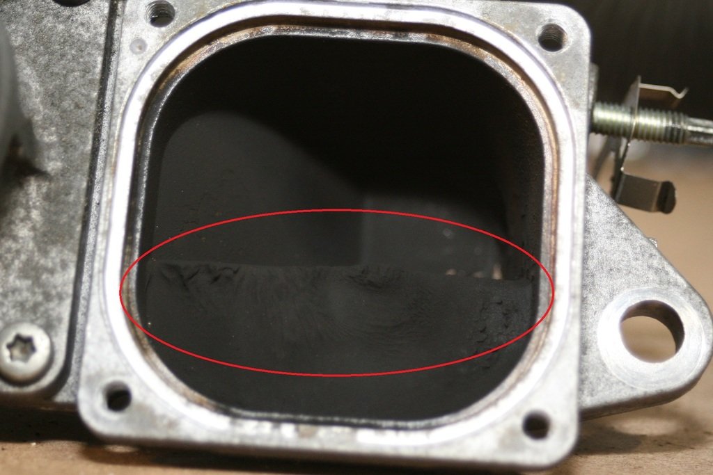

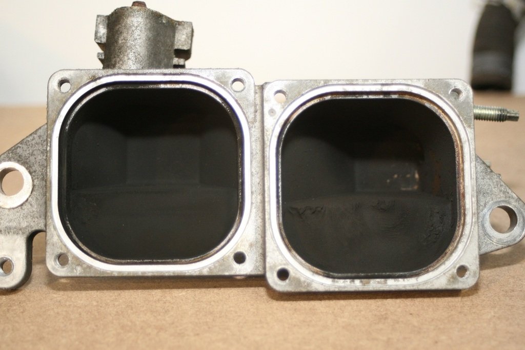

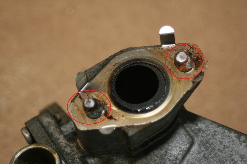

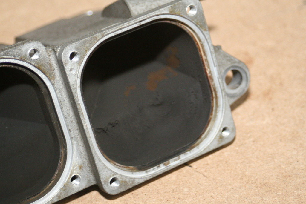

    Just went through the pics I took for DIY thread and here are some showing what a 135k mile valve looks like.
    Both valve reeds were definitely stuck open
    Lots of carbon build up in the vavle housing
    Both bolts on the exhaust intlet (forward) manifold broke off, looking at the bolts in the manifold it appears as if they may have been welded in, not sure though. I replaced them on the install.
    And most importantly, after install and clearing the codes I no longer have the lights or limp mode!

    I got my valve assy for around $450
