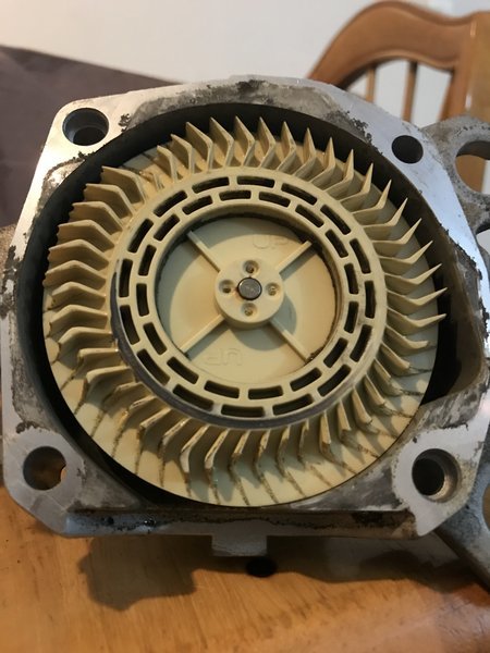

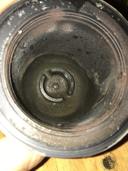

    So after searching around found a new air pump on eBay for under $200. Took apart the pump that was giving me issues and this is what I found. Broken fan blades and water in the reservoir. Fuck Toyota for trying to charge me $1300 to repair this part. It took me 2 minutes and zero labor. Part came with a 1yr warranty as well. IMG_0792.jpg IMG_0791.jpg

    WOW! that's really chewed up!

    Were there plastic pieces in the pump? Did you check the air line that feeds the valve assy? I'd be a little worried about where all that plastic went. Good job on doing it yourself and saving lots of money.

    This.
    That plastic is now sitting at the valves with a very real chance of keeping the valve from closing and putting you into limp.

    Yeah I'm thinking that too, is there any way I can look into the valve and clean it out. I'm going to replace it, just waiting on parts to come in. Any recommendations would help. Looking to hit the road this week last thing I want is limp mode.

    Check the hoses from the pump to the valves. The plastic pieces are likely still in there.

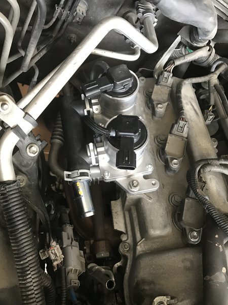

    Justin
    Louisville Ky
    2012 TRD Sport Tacoma
    Got my new diverter valve and body on Friday. Removed old body and installed new body in about an hour (along with oil/filter change and cleaning of air filter). So far so good. No CEL, codes or dreaded limp mode... fingers crossed I'll get 114,000 miles on the new part.
    Thanks to you guys that supplied part #'s and added advice.
