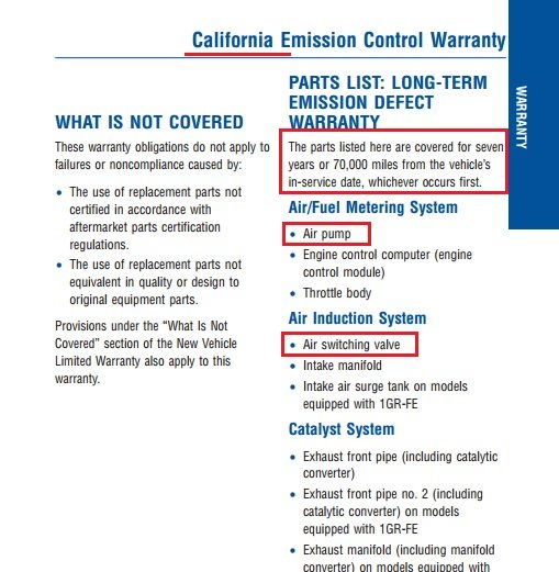

    Go find a competent dealer. It says so on the warranty manual page 25.

    You would think that the warranty information listed above would cover it - no questions. It's amazing we are having so much trouble getting compensated.
    Not sure if this is a dumb question or not, but for people on the right coast, would the "California Emission Control Warranty" help us over here, or is that something specific to only CA?

    CA is the only state that has it's own different emissions warranty. If you look at your emissions tag under your hood, it might say something like 49 state compliant.

    See my post #309. CA emissions warranty states that is covered if you're under the 70k miles.
