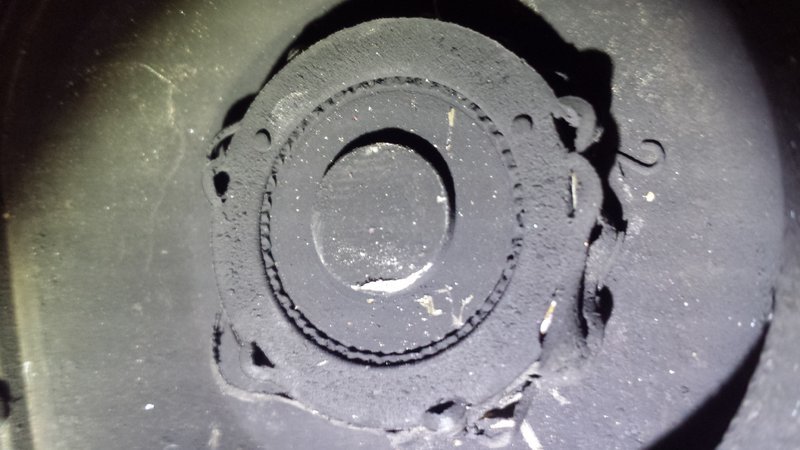

  12. Jun 13, 2017 at 8:44 AM
    #332
    Erkon
    Erkon Well-Known Member
    Nov 28, 2015
    #170839
    199
    Wisconsin
    2012 Pyrite Mica Tacoma TRD Supercharged
    The seal on the plunger failed on mine
