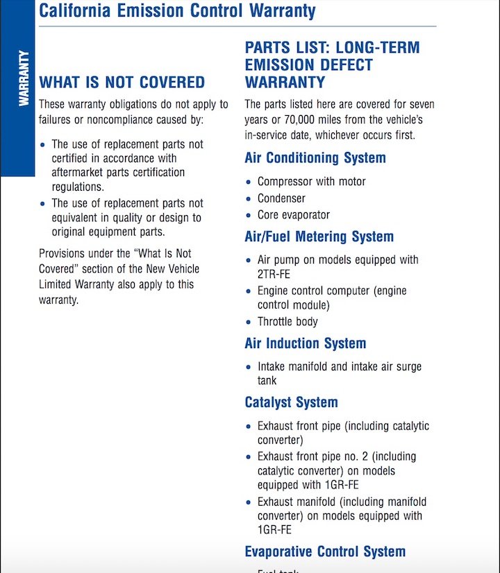

    Too few to list.
    Perhaps the 2012 Warranty booklet was not yet updated as it only mentioned the 4cyl since 2012 is the first year for the V6. Go by what I posted and print it if you have to and show the dealer.
