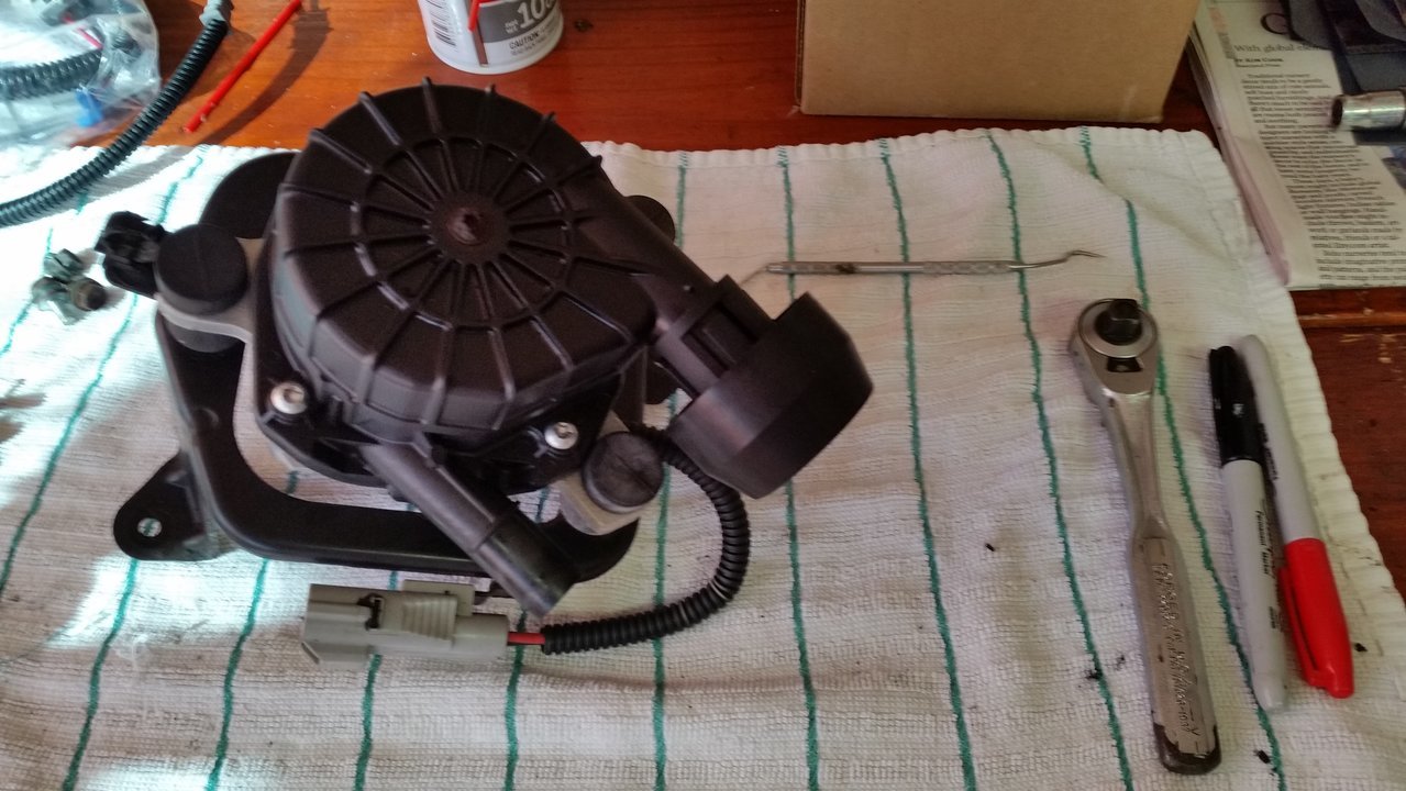

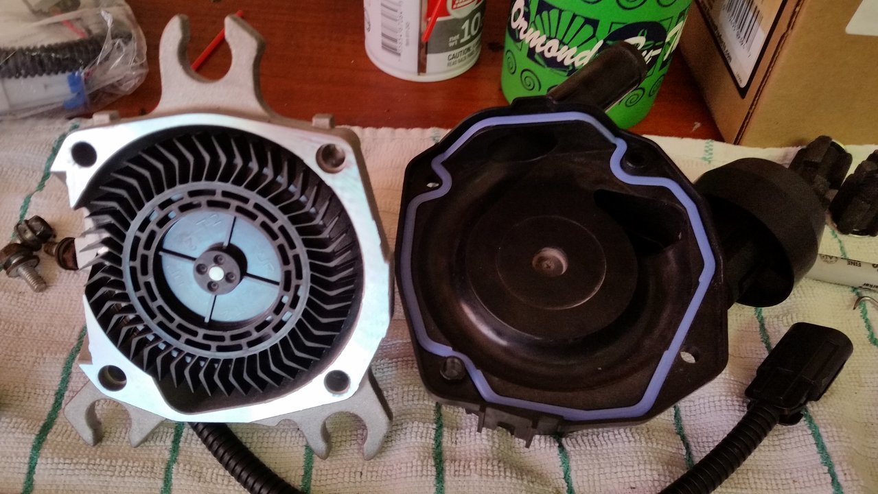

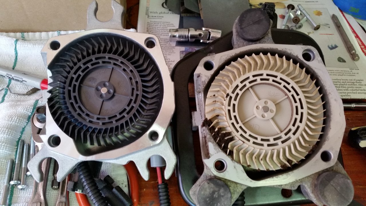

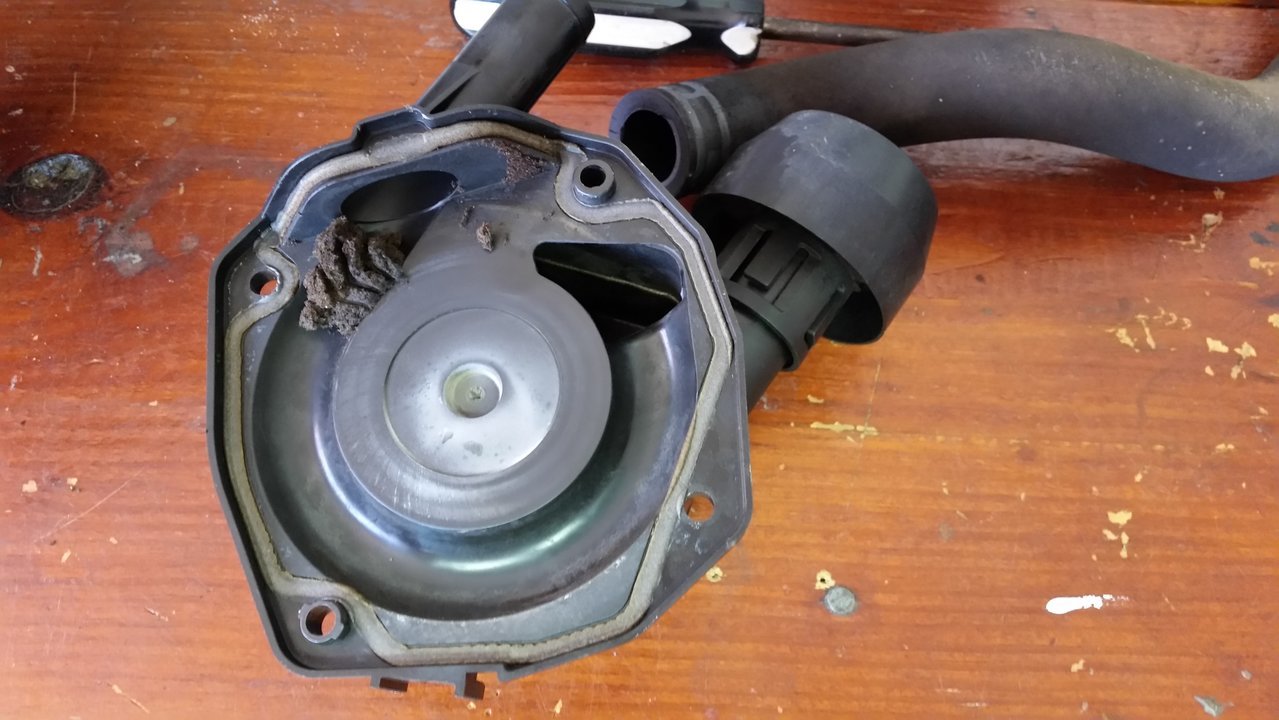

    Replaced the air injection pump today on my 2007 2.7 tacoma. Thanks first to AZ_Tacoma_2008 for his research and PM about using a Dorman 316-010 instead of a factory unit,20171218_124434.jpg 20171218_124448.jpg 20171218_125713.jpg 20171218_130358.jpg 20171218_133322.jpg as well as warning me that I would have to reuse the wiring pigtail from the old pump. It was a easy to do and took me about 2 hours with a break in between to rest a spell. As you can see, the old foam filter had disintegrated and clogged the opening as well as binding up the motor and causing it to burn up. I made sure there was no more debris in the top (which you reuse) and in the hose to the diverter valve. After installation I reattached the negative lead on the battery and started it up....no CEL now and no weird "loud intake" sound at startup. Photos attached. Cost= 104 with shipping from Amazon. Thanks to all on this forum! Merry Christmas!

    dieselfan, you can purchase the pump and diverter valves online and do it yourself. I bought a Toyota OEM diverter valve online and was fortunate to get the Dorman aftermarket pump for a reasonable price thanks to the work of another member here. I realize the v6 has 2 diverter valves but they are not hard to change and disconnecting the battery prior to the repair is all you need, as once the work is done the code will be cleared. $2000? please. The parts and 2-3 hrs. of your time is all it takes. Everything is easy to get to as well. and 98 to read the code? a friend has one of the computers and he had my codes in 10 minutes! Start checking online for the parts and good luck!
