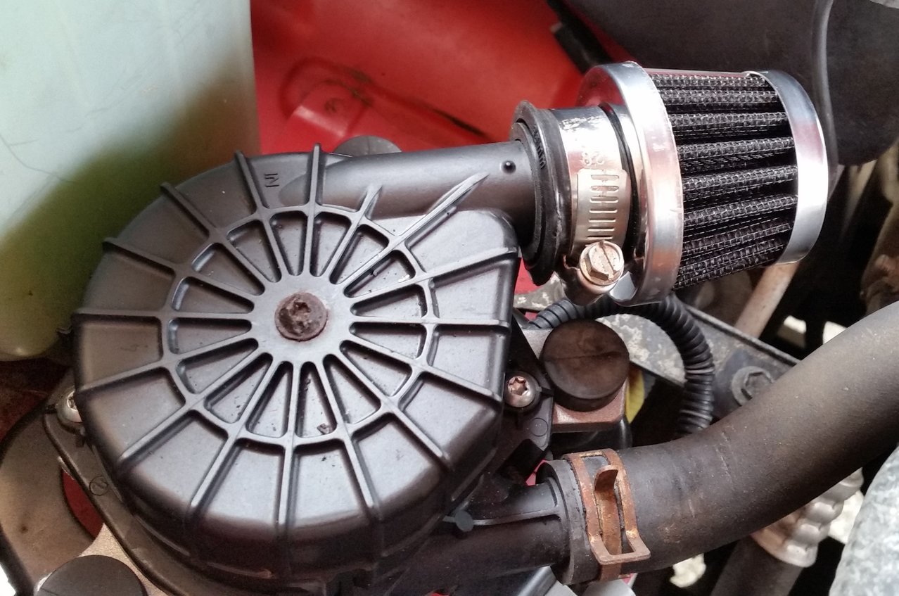

    40,085
    Inside that round housing with the screw that looks rusted to hell should be the OEM internal foam filter that you want to remove before it disintegrates and is ingested into the valves. The idea is to remove the OEM internal filter, and replace with the after market Uni filter externally.

    Leveling kit, roll bar
    From a 2012 4.0 V6

    2007 Tacoma 4WD
    HI, My foam filter had failed. If you go back to post 463 on page 24 in this thread you can see photos of the filter (what is left) jammed in the old fan blades. Funny thing about the rusted screw is that as bad as it looks it was easily removable. Next time I am by my fave fastener place I am going to remove it and find a replacement. I live one block from the Ocean and I have replaced lots of fasteners in the engine compartment and bed. It's a work in progress! Hope this helps. Tim

    40,085
    Ah, cool, OK, I hadn't seen that. Nice. Just wanted to make sure you hadn't missed a step!
