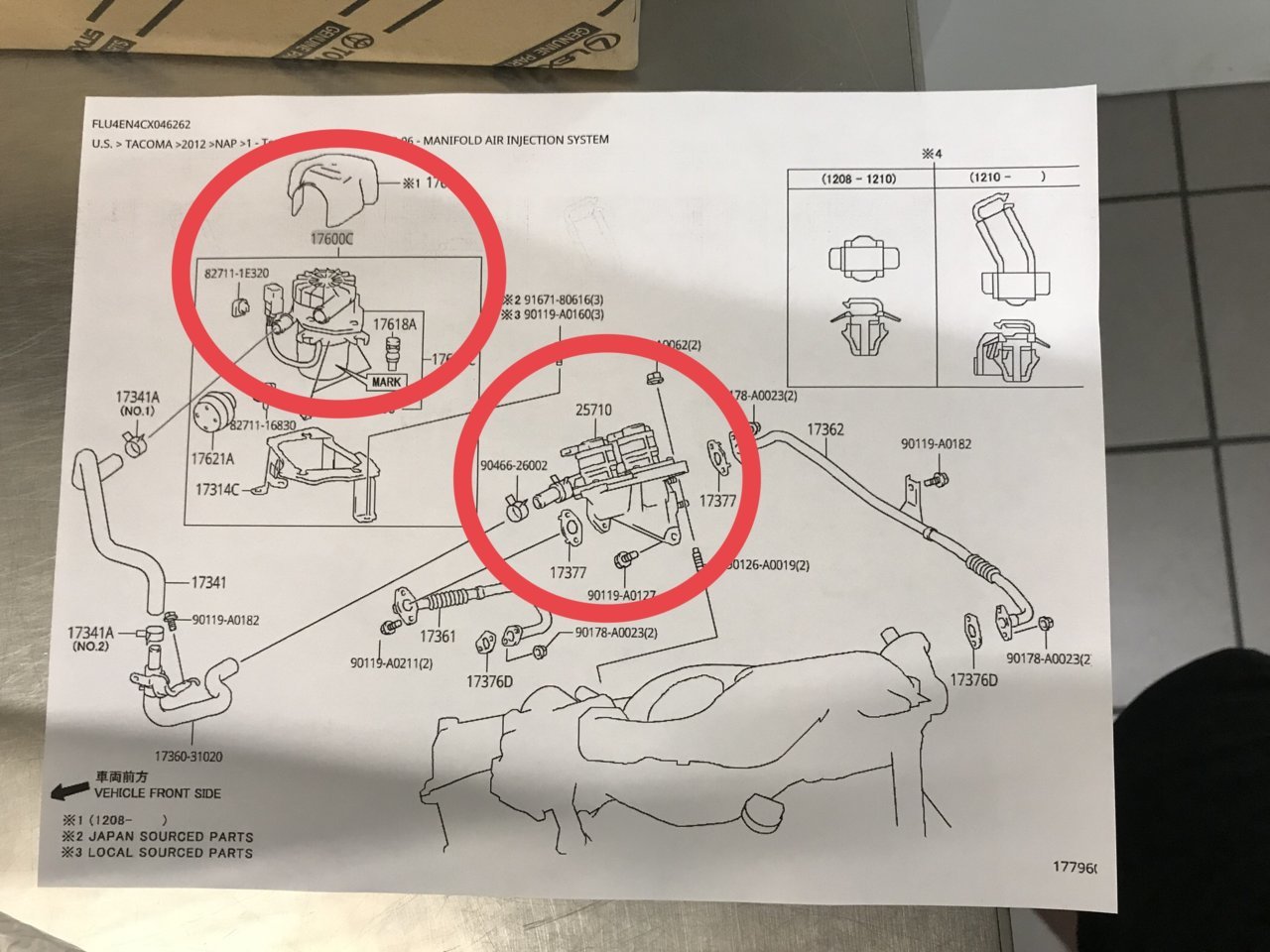

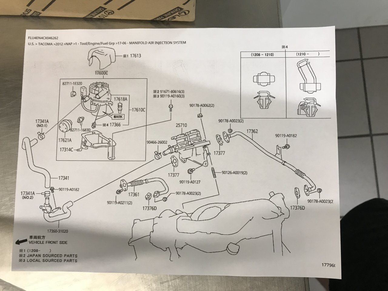

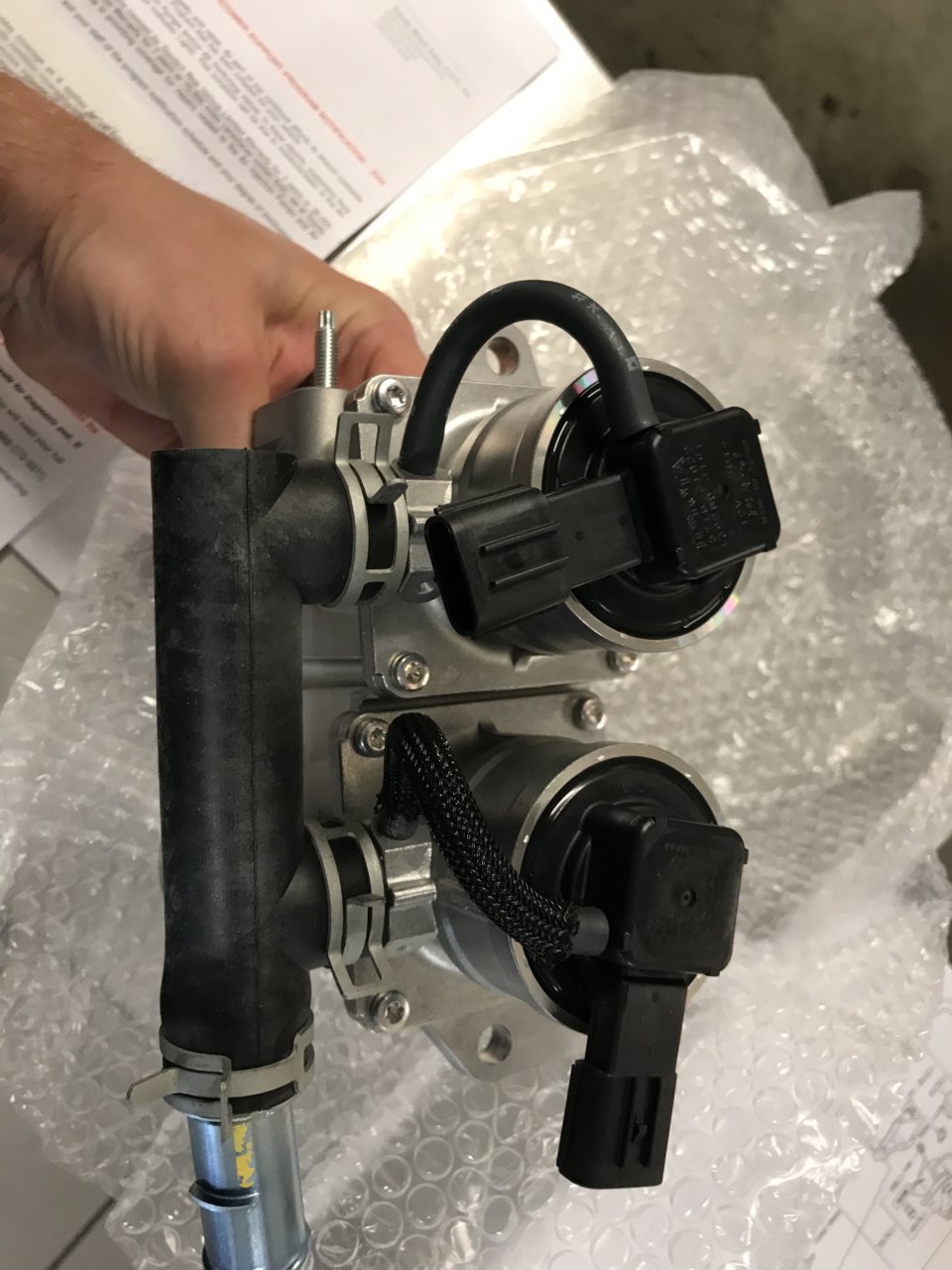

    So they ordered just the pump, but I checked with the parts guy and they had the valves in stock. I guess they are replacing both as well as the pump cover, which it says the valves, pump, and pump cover are covered by the warranty. I’m glad I checked the parts, not sure if they were planning on replacing just the pump. Either way the parts guy and service people said ok, and were helpful. Now just waiting while they do the work.

    Update: So the repair was done in about 4 hours, seems to be running fine now. Here is what was replaced.
